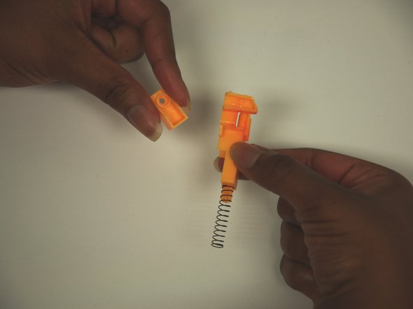

    • Pull the front chamber lock spring out of its seat.
    • Pull the front chamber lock down and out of the rifle barrel.
    • There are two pieces to this mechanism.

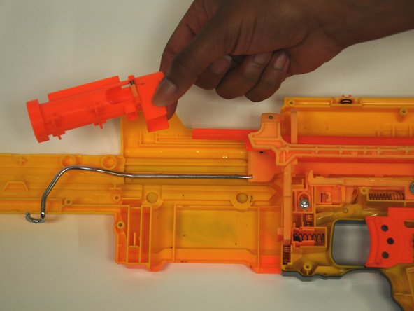

  13. Nerf Alpha Trooper CS-18 Hammer Rod Replacement: crwdns2935265:013crwdnd2935265:01crwdnd2935265:02crwdne2935265:0 Nerf Alpha Trooper CS-18 Hammer Rod Replacement: crwdns2935265:013crwdnd2935265:02crwdnd2935265:02crwdne2935265:0
    • Hold down the spring that locks the chamber to the forward position, then slide the chamber to the rear of the rifle.
    • Remove front barrel guide.
  14. Nerf Alpha Trooper CS-18 Hammer Rod Replacement: crwdns2935265:014crwdnd2935265:01crwdnd2935265:02crwdne2935265:0 Nerf Alpha Trooper CS-18 Hammer Rod Replacement: crwdns2935265:014crwdnd2935265:02crwdnd2935265:02crwdne2935265:0
    • Push the barrel forward and remove the square piece that holds the back of the barrel in place.

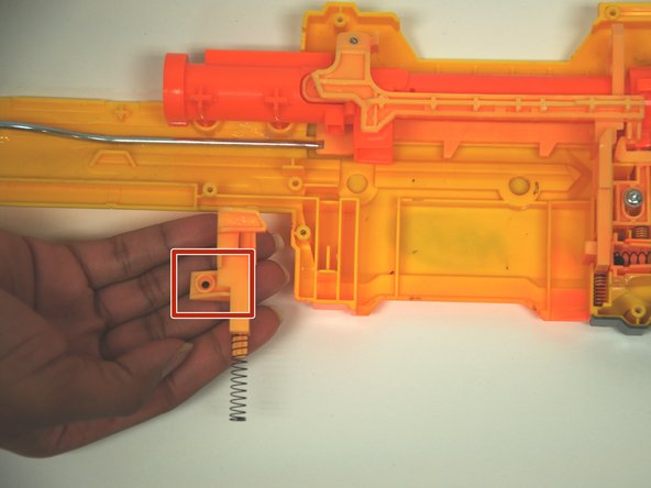

  16. Nerf Alpha Trooper CS-18 Hammer Rod Replacement: crwdns2935265:016crwdnd2935265:01crwdnd2935265:02crwdne2935265:0 Nerf Alpha Trooper CS-18 Hammer Rod Replacement: crwdns2935265:016crwdnd2935265:02crwdnd2935265:02crwdne2935265:0
    • Hold the slide lock down and pull the bullet chamber assembly up and out of the rifle.
    • Part of the magazine lock mechanism should come along with it.
    • The hammer rod mechanism is flipped over in the second picture. The rod should face the front of the gun with the screw facing down.
    • Remove the screw and replace the hammer rod.
