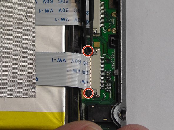

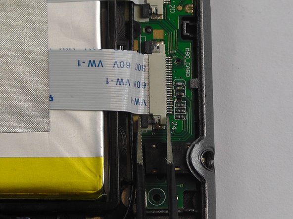

  5. Neo3Do Wire Replacement, Wire: crwdns2935265:05crwdnd2935265:01crwdnd2935265:03crwdne2935265:0 Neo3Do Wire Replacement, Wire: crwdns2935265:05crwdnd2935265:02crwdnd2935265:03crwdne2935265:0 Neo3Do Wire Replacement, Wire: crwdns2935265:05crwdnd2935265:03crwdnd2935265:03crwdne2935265:0
    • Starting with an open back panel, take your tweezers and use them to pull back the black tabs on the connector.
  6. Neo3Do Wire Replacement: crwdns2935265:06crwdnd2935265:01crwdnd2935265:01crwdne2935265:0
    • Pull the wire completely from the socket.
    • Check the metallic parts for signs of damage or corrosion. If either exists, you might need to replace the battery entirely.

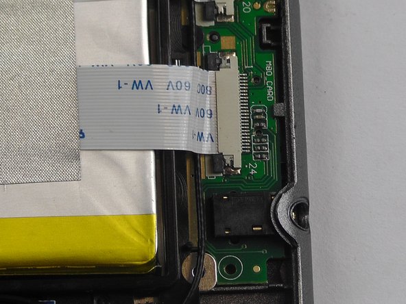

  7. Neo3Do Wire Replacement: crwdns2935265:07crwdnd2935265:01crwdnd2935265:01crwdne2935265:0
    • Re-insert the wire into the socket.

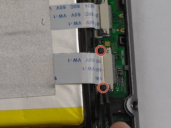

  8. Neo3Do Wire Replacement: crwdns2935265:08crwdnd2935265:01crwdnd2935265:03crwdne2935265:0 Neo3Do Wire Replacement: crwdns2935265:08crwdnd2935265:02crwdnd2935265:03crwdne2935265:0 Neo3Do Wire Replacement: crwdns2935265:08crwdnd2935265:03crwdnd2935265:03crwdne2935265:0
    • Using the tweezers, push the black tabs back in.
