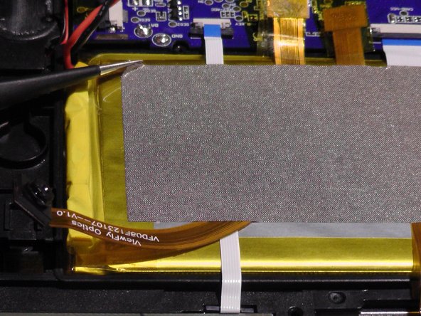

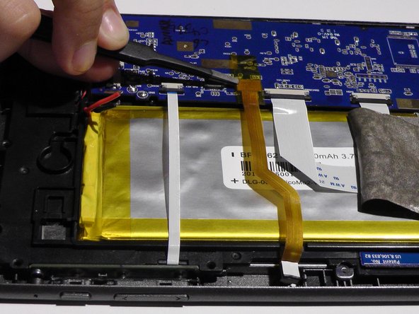

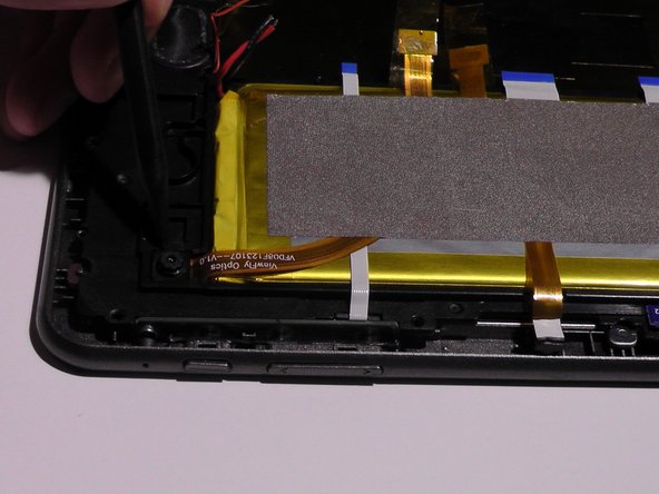

    • Remove the front and back camera from their sockets.
    • Remove the silver tape from the battery.

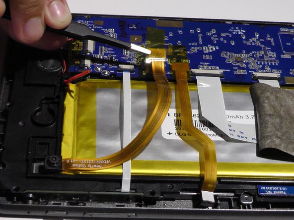

  6. Neo3Do Front and Back Camera Replacement: crwdns2935265:06crwdnd2935265:01crwdnd2935265:03crwdne2935265:0 Neo3Do Front and Back Camera Replacement: crwdns2935265:06crwdnd2935265:02crwdnd2935265:03crwdne2935265:0 Neo3Do Front and Back Camera Replacement: crwdns2935265:06crwdnd2935265:03crwdnd2935265:03crwdne2935265:0
    • Remove the ribbon wire from the socket.
    • Gripping the wire belt and pulling upwards may cause damage, be sure to avoid it.
