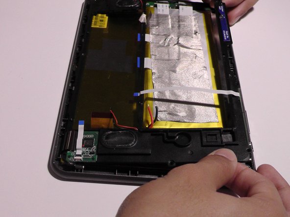

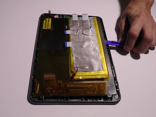

    • Turn the Neo3DO face down so that the logo is facing toward you.
    • Insert the plastic opening tool between the metal frame and the plastic back panel, as shown.
  2. Neo3Do Audio PCB Replacement: crwdns2935265:02crwdnd2935265:01crwdnd2935265:02crwdne2935265:0 Neo3Do Audio PCB Replacement: crwdns2935265:02crwdnd2935265:02crwdnd2935265:02crwdne2935265:0
    • Gently pry the back panel upwards.
    • Ensure the tool does not slip into the device and damage the internals.
  3. Neo3Do Audio PCB Replacement: crwdns2935265:03crwdnd2935265:01crwdnd2935265:02crwdne2935265:0 Neo3Do Audio PCB Replacement: crwdns2935265:03crwdnd2935265:02crwdnd2935265:02crwdne2935265:0
    • Once the back panel has been pried away from the bottom and sides of the Neo3DO, lift the back panel up and away from the tablet.
  4. Neo3Do Audio PCB Replacement: crwdns2935265:04crwdnd2935265:01crwdnd2935265:01crwdne2935265:0
    • When replacing the back panel, place the top edge of the back panel against the top edge of the Neo3DO, as shown.
    • The top edge of the device is the edge closest to the camera. The top of the back panel is the side with the hole for the camera.

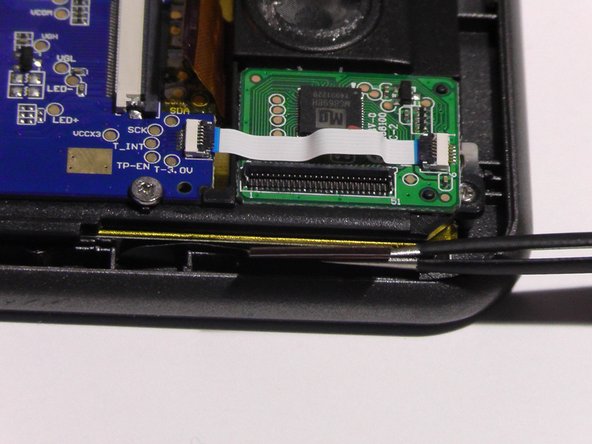

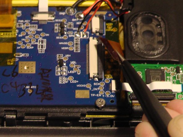

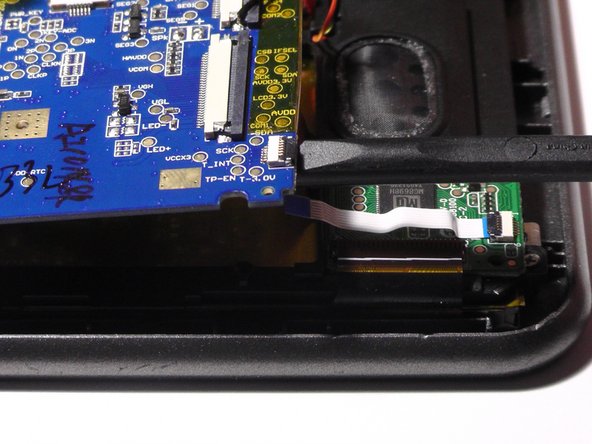

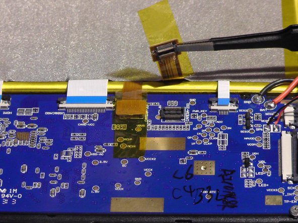

  5. Neo3Do Audio PCB Replacement, Motherboard: crwdns2935265:05crwdnd2935265:01crwdnd2935265:03crwdne2935265:0 Neo3Do Audio PCB Replacement, Motherboard: crwdns2935265:05crwdnd2935265:02crwdnd2935265:03crwdne2935265:0 Neo3Do Audio PCB Replacement, Motherboard: crwdns2935265:05crwdnd2935265:03crwdnd2935265:03crwdne2935265:0

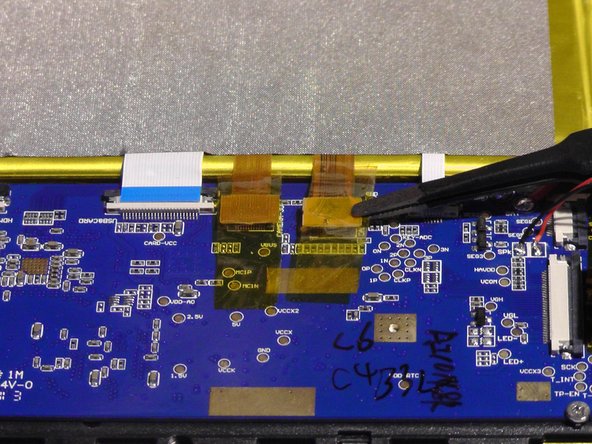

    • Remove all the tape attached to the motherboard.

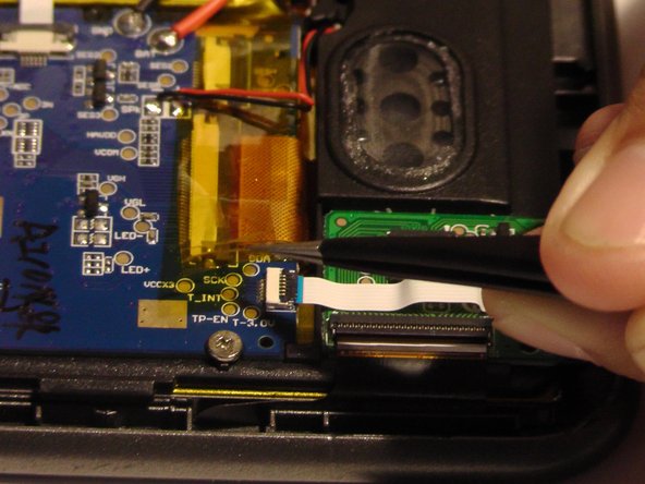

  6. Neo3Do Audio PCB Replacement: crwdns2935265:06crwdnd2935265:01crwdnd2935265:03crwdne2935265:0 Neo3Do Audio PCB Replacement: crwdns2935265:06crwdnd2935265:02crwdnd2935265:03crwdne2935265:0 Neo3Do Audio PCB Replacement: crwdns2935265:06crwdnd2935265:03crwdnd2935265:03crwdne2935265:0

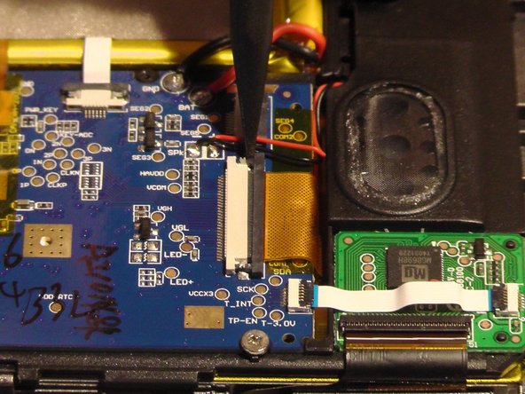

    • Pull out the black tabs using the plastic spudger.
    • All sockets that require the same step are marked in the first photo.

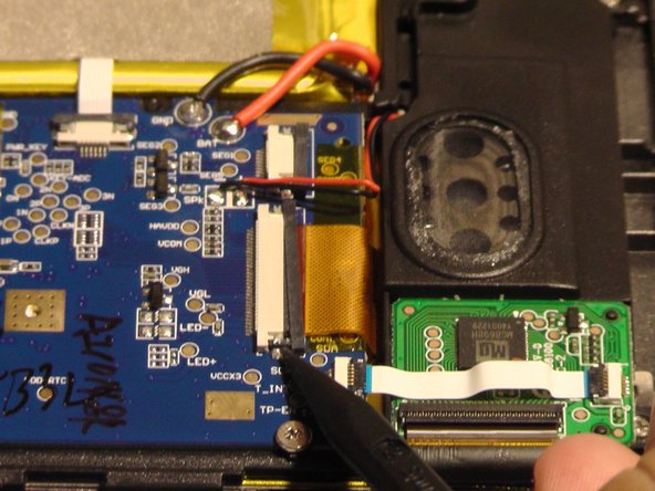

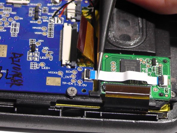

  7. Neo3Do Audio PCB Replacement: crwdns2935265:07crwdnd2935265:01crwdnd2935265:02crwdne2935265:0 Neo3Do Audio PCB Replacement: crwdns2935265:07crwdnd2935265:02crwdnd2935265:02crwdne2935265:0
    • Remove the wire belt from the socket.
  8. Neo3Do Audio PCB Replacement: crwdns2935265:08crwdnd2935265:01crwdnd2935265:03crwdne2935265:0 Neo3Do Audio PCB Replacement: crwdns2935265:08crwdnd2935265:02crwdnd2935265:03crwdne2935265:0 Neo3Do Audio PCB Replacement: crwdns2935265:08crwdnd2935265:03crwdnd2935265:03crwdne2935265:0
    • Lift the black tab and then remove the wire belt.
  9. Neo3Do Audio PCB Replacement: crwdns2935265:09crwdnd2935265:01crwdnd2935265:03crwdne2935265:0 Neo3Do Audio PCB Replacement: crwdns2935265:09crwdnd2935265:02crwdnd2935265:03crwdne2935265:0 Neo3Do Audio PCB Replacement: crwdns2935265:09crwdnd2935265:03crwdnd2935265:03crwdne2935265:0

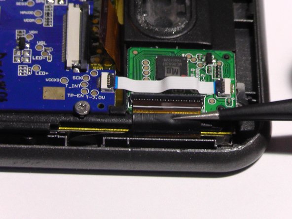

  10. Neo3Do Audio PCB Replacement: crwdns2935265:010crwdnd2935265:01crwdnd2935265:03crwdne2935265:0 Neo3Do Audio PCB Replacement: crwdns2935265:010crwdnd2935265:02crwdnd2935265:03crwdne2935265:0 Neo3Do Audio PCB Replacement: crwdns2935265:010crwdnd2935265:03crwdnd2935265:03crwdne2935265:0
    • Grip the side of the tab and pull upwards to remove it from the socket.
    • Gripping the wire belt and pulling upwards may cause damage, be sure to avoid it.

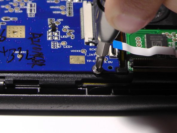

  11. Neo3Do Audio PCB Replacement: crwdns2935265:011crwdnd2935265:01crwdnd2935265:02crwdne2935265:0 Neo3Do Audio PCB Replacement: crwdns2935265:011crwdnd2935265:02crwdnd2935265:02crwdne2935265:0
    • Remove the screws using the J0 head screwdriver.
    • All screws that require the same step are marked in the first photo.

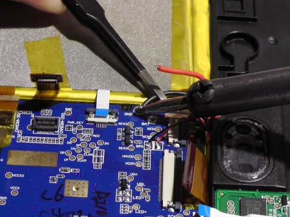

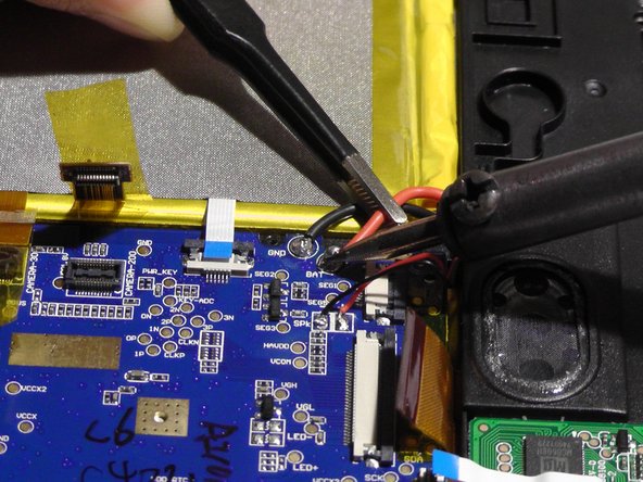

  12. Neo3Do Audio PCB Replacement: crwdns2935265:012crwdnd2935265:01crwdnd2935265:03crwdne2935265:0 Neo3Do Audio PCB Replacement: crwdns2935265:012crwdnd2935265:02crwdnd2935265:03crwdne2935265:0 Neo3Do Audio PCB Replacement: crwdns2935265:012crwdnd2935265:03crwdnd2935265:03crwdne2935265:0
    • Grip the active(red) wire and apply the soldering tool until the solder is soft enough for the wire to be removed.
    • Repeat the same process to remove the neutral(black) wire.
    • All wires that require the same steps are marked in the first photo.
    • The soldering tool is extremely hot, use with caution.

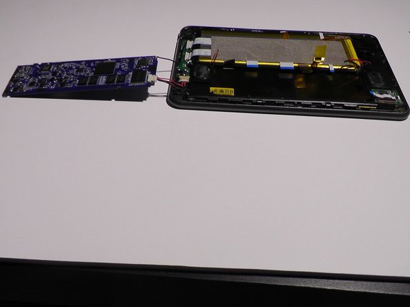

  13. Neo3Do Audio PCB Replacement: crwdns2935265:013crwdnd2935265:01crwdnd2935265:03crwdne2935265:0 Neo3Do Audio PCB Replacement: crwdns2935265:013crwdnd2935265:02crwdnd2935265:03crwdne2935265:0 Neo3Do Audio PCB Replacement: crwdns2935265:013crwdnd2935265:03crwdnd2935265:03crwdne2935265:0

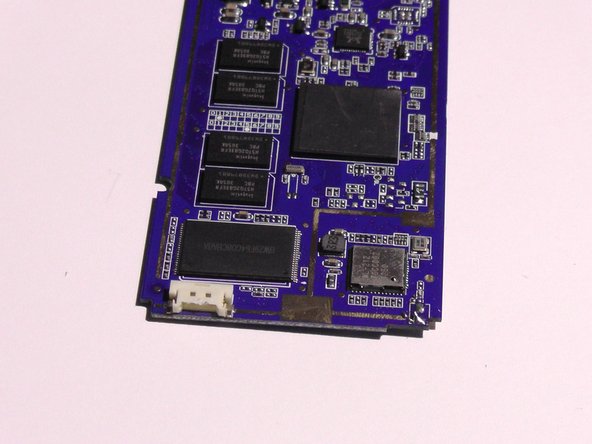

    • Use the flat end of the plastic spudger to remove the motherboard and turn it underside-up.
  14. Neo3Do Audio PCB Replacement: crwdns2935265:014crwdnd2935265:01crwdnd2935265:02crwdne2935265:0 Neo3Do Audio PCB Replacement: crwdns2935265:014crwdnd2935265:02crwdnd2935265:02crwdne2935265:0
    • Remove the plug from the motherboard socket.
  15. Neo3Do Audio PCB Replacement: crwdns2935265:015crwdnd2935265:01crwdnd2935265:03crwdne2935265:0 Neo3Do Audio PCB Replacement: crwdns2935265:015crwdnd2935265:02crwdnd2935265:03crwdne2935265:0 Neo3Do Audio PCB Replacement: crwdns2935265:015crwdnd2935265:03crwdnd2935265:03crwdne2935265:0

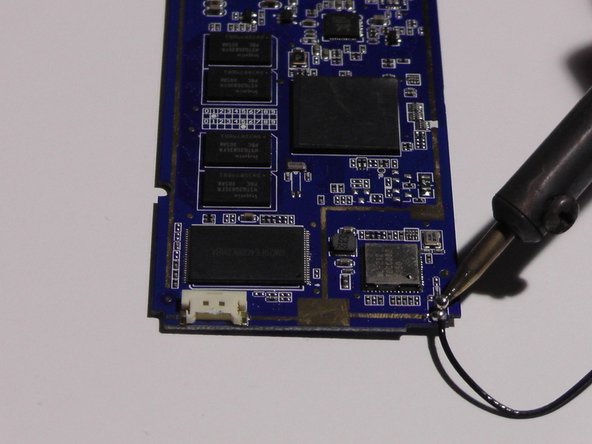

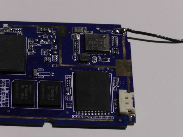

    • Grip the wire and apply the soldering tool until the solder is soft enough for the wire to be removed.

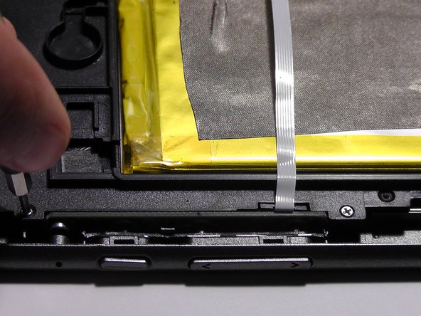

  16. Neo3Do Audio PCB Replacement, Battery & LED screen: crwdns2935265:016crwdnd2935265:01crwdnd2935265:02crwdne2935265:0 Neo3Do Audio PCB Replacement, Battery & LED screen: crwdns2935265:016crwdnd2935265:02crwdnd2935265:02crwdne2935265:0
    • Remove the screws with a J000 screwdriver

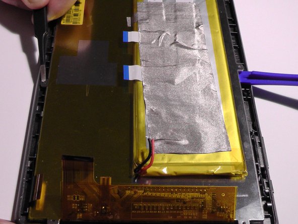

  17. Neo3Do Audio PCB Replacement: crwdns2935265:017crwdnd2935265:01crwdnd2935265:02crwdne2935265:0 Neo3Do Audio PCB Replacement: crwdns2935265:017crwdnd2935265:02crwdnd2935265:02crwdne2935265:0
    • Use the plastic removal tool to remove the plastic frame.
  18. Neo3Do Audio PCB Replacement: crwdns2935265:018crwdnd2935265:01crwdnd2935265:03crwdne2935265:0 Neo3Do Audio PCB Replacement: crwdns2935265:018crwdnd2935265:02crwdnd2935265:03crwdne2935265:0 Neo3Do Audio PCB Replacement: crwdns2935265:018crwdnd2935265:03crwdnd2935265:03crwdne2935265:0
    • Using the plastic removal tool, lift the LED screen from the battery side, and use the tweezers to help lift the LED screen upwards.

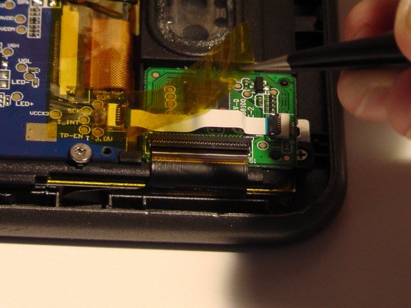

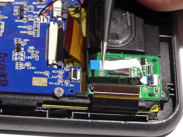

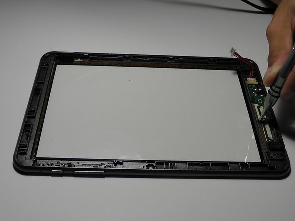

  19. Neo3Do Audio PCB Replacement, Audio PCB: crwdns2935265:019crwdnd2935265:01crwdnd2935265:02crwdne2935265:0 Neo3Do Audio PCB Replacement, Audio PCB: crwdns2935265:019crwdnd2935265:02crwdnd2935265:02crwdne2935265:0
    • Remove the screws using the Philip's PH000 screwdriver.

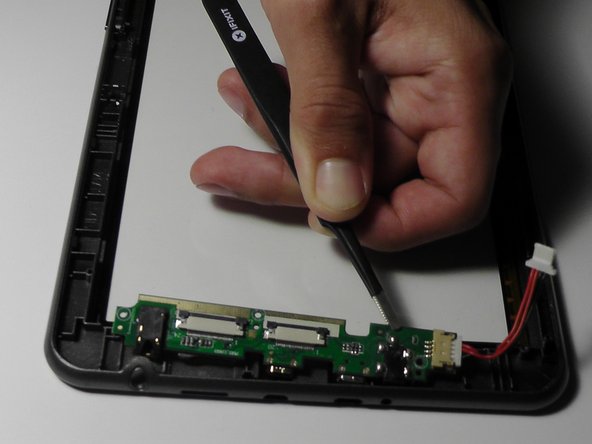

  20. Neo3Do Audio PCB Replacement: crwdns2935265:020crwdnd2935265:01crwdnd2935265:02crwdne2935265:0 Neo3Do Audio PCB Replacement: crwdns2935265:020crwdnd2935265:02crwdnd2935265:02crwdne2935265:0
    • Use the plastic removal tool to pry the audio PCB and pull away from the frame to remove it.
