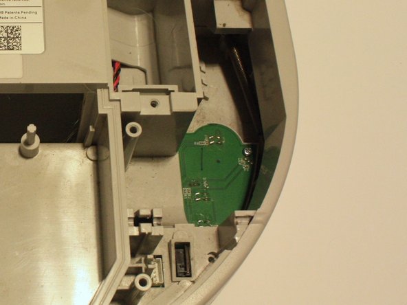

  5. Neato XV-21 Wheels Replacement, Wheels: crwdns2935265:05crwdnd2935265:01crwdnd2935265:01crwdne2935265:0
    • Pinch and pull the white connector, indicated in the image, to disconnect the wheel from the robot. Repeat for both wheels
  6. Neato XV-21 Wheels Replacement: crwdns2935265:06crwdnd2935265:01crwdnd2935265:01crwdne2935265:0
    • Slide out dowel rod connecting the wheel to the robot.
  7. Neato XV-21 Wheels Replacement: crwdns2935265:07crwdnd2935265:01crwdnd2935265:02crwdne2935265:0 Neato XV-21 Wheels Replacement: crwdns2935265:07crwdnd2935265:02crwdnd2935265:02crwdne2935265:0
    • Lift the wheel so the spring is exposed
    • Pay particular attention to how the wheel is placed to replicate during reinsertion
    • Unhook the spring from robot
    • Lift the wheel from the cavity
