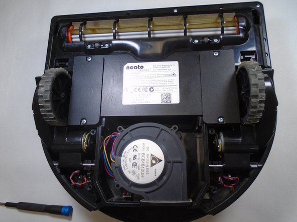

    • Place the Neato with the bottom side facing up.
  2. Neato XV Signature Wheel Assembly Replacement: crwdns2935265:02crwdnd2935265:01crwdnd2935265:01crwdne2935265:0
    • Remove the four machine screws securing the main compartment plate using a Phillips #0 screwdriver.
  3. Neato XV Signature Wheel Assembly Replacement: crwdns2935265:03crwdnd2935265:01crwdnd2935265:02crwdne2935265:0 Neato XV Signature Wheel Assembly Replacement: crwdns2935265:03crwdnd2935265:02crwdnd2935265:02crwdne2935265:0
    • Remove the main compartment plate, exposing the wheel axis and fan.

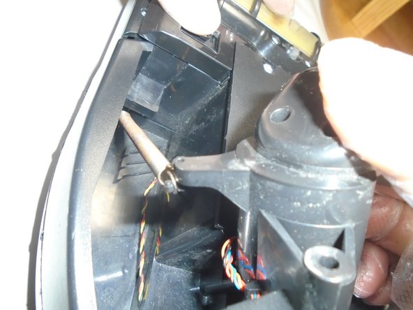

    • Remove the axle bar from the wheel mount, exposing the suspension spring.
  6. Neato XV Signature Wheel Assembly Replacement: crwdns2935265:06crwdnd2935265:01crwdnd2935265:02crwdne2935265:0 Neato XV Signature Wheel Assembly Replacement: crwdns2935265:06crwdnd2935265:02crwdnd2935265:02crwdne2935265:0
    • Unlatch the suspension spring from the wheel mount, exposing the wheel connector cable.

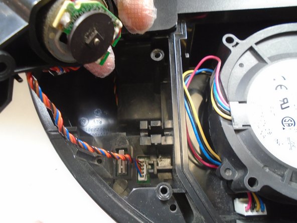

  7. Neato XV Signature Wheel Assembly Replacement: crwdns2935265:07crwdnd2935265:01crwdnd2935265:01crwdne2935265:0
    • Unplug the wheel connector cable.
    • Repeat steps 4-7 with the other wheel.
