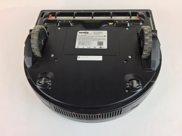

    • Flip your Neato XV Signature robot over so that so are looking at the underside of it.

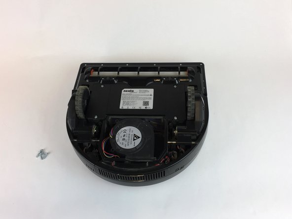

  2. Neato XV Signature Motor Assembly Replacement: crwdns2935265:02crwdnd2935265:01crwdnd2935265:01crwdne2935265:0
    • Using a Phillips head #2 screwdriver, unscrew the four 14 mm (1.4 cm) screws on the external panel that covers the motor assembly.
    • Be sure not to lose the screws.
  3. Neato XV Signature Motor Assembly Replacement: crwdns2935265:03crwdnd2935265:01crwdnd2935265:02crwdne2935265:0 Neato XV Signature Motor Assembly Replacement: crwdns2935265:03crwdnd2935265:02crwdnd2935265:02crwdne2935265:0
    • Use plastic spudger to gently pry off the external panel to expose the motor assembly.

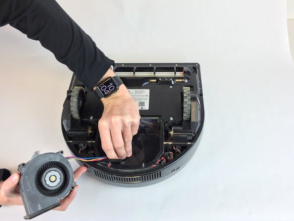

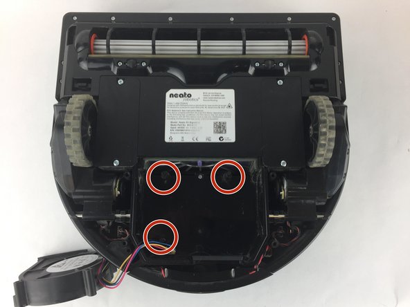

  4. Neato XV Signature Motor Assembly Replacement: crwdns2935265:04crwdnd2935265:01crwdnd2935265:02crwdne2935265:0 Neato XV Signature Motor Assembly Replacement: crwdns2935265:04crwdnd2935265:02crwdnd2935265:02crwdne2935265:0
    • Gently lift the motor assembly straight up, out of place, being aware of the four mounting posts that hold the motor firmly in place.

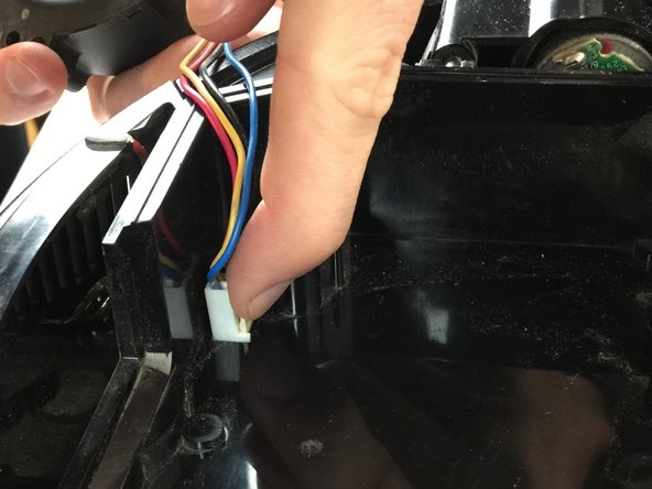

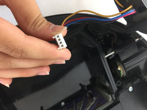

  5. Neato XV Signature Motor Assembly Replacement: crwdns2935265:05crwdnd2935265:01crwdnd2935265:03crwdne2935265:0 Neato XV Signature Motor Assembly Replacement: crwdns2935265:05crwdnd2935265:02crwdnd2935265:03crwdne2935265:0 Neato XV Signature Motor Assembly Replacement: crwdns2935265:05crwdnd2935265:03crwdnd2935265:03crwdne2935265:0
    • Press the tab and gently lift straight up to disconnect the motor wires.
  6. Neato XV Signature Motor Assembly Replacement: crwdns2935265:06crwdnd2935265:01crwdnd2935265:03crwdne2935265:0 Neato XV Signature Motor Assembly Replacement: crwdns2935265:06crwdnd2935265:02crwdnd2935265:03crwdne2935265:0 Neato XV Signature Motor Assembly Replacement: crwdns2935265:06crwdnd2935265:03crwdnd2935265:03crwdne2935265:0
    • After disconnecting the wire clip, remove the motor assembly out of the compartment.
