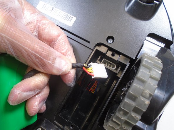

    • Place the Neato with the bottom side facing up.
  2. Neato XV Signature Battery Replacement: crwdns2935265:02crwdnd2935265:01crwdnd2935265:01crwdne2935265:0
  3. Neato XV Signature Battery Replacement: crwdns2935265:03crwdnd2935265:01crwdnd2935265:02crwdne2935265:0 Neato XV Signature Battery Replacement: crwdns2935265:03crwdnd2935265:02crwdnd2935265:02crwdne2935265:0
    • Remove the battery compartment covers.
  4. Neato XV Signature Battery Replacement: crwdns2935265:04crwdnd2935265:01crwdnd2935265:01crwdne2935265:0
    • Lift up the battery pack to access the battery cable connection.
  5. Neato XV Signature Battery Replacement: crwdns2935265:05crwdnd2935265:01crwdnd2935265:01crwdne2935265:0
    • Unplug the battery cable by gently pulling on the cable connector.
  6. Neato XV Signature Battery Replacement: crwdns2935265:06crwdnd2935265:01crwdnd2935265:02crwdne2935265:0 Neato XV Signature Battery Replacement: crwdns2935265:06crwdnd2935265:02crwdnd2935265:02crwdne2935265:0
    • Repeat Steps 4 and 5 for the second battery.
