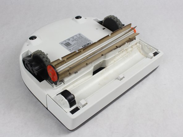

    • Place the vacuum on its back so the brushes are visible.
  2. Neato Botvac D8000 Wheel Replacement: crwdns2935265:02crwdnd2935265:01crwdnd2935265:03crwdne2935265:0 Neato Botvac D8000 Wheel Replacement: crwdns2935265:02crwdnd2935265:02crwdnd2935265:03crwdne2935265:0 Neato Botvac D8000 Wheel Replacement: crwdns2935265:02crwdnd2935265:03crwdnd2935265:03crwdne2935265:0
    • Remove the four 10 mm screws with a Torx T10 screwdriver.
  3. Neato Botvac D8000 Wheel Replacement: crwdns2935265:03crwdnd2935265:01crwdnd2935265:02crwdne2935265:0 Neato Botvac D8000 Wheel Replacement: crwdns2935265:03crwdnd2935265:02crwdnd2935265:02crwdne2935265:0

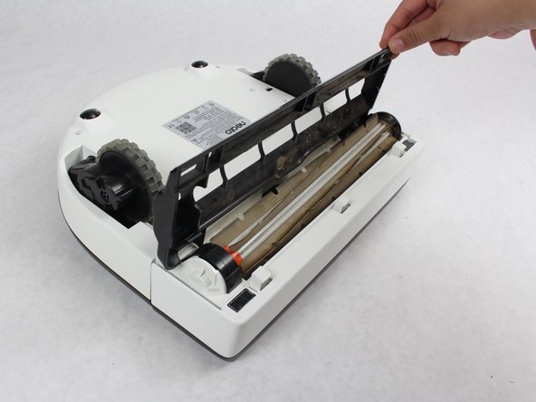

    • Remove the rotary brush simply by grabbing it firmly and pulling it off.
    • Once you have removed your rotary brush and 4 bolts, you can easy remove the brush guard.
  4. Neato Botvac D8000 Wheel Replacement: crwdns2935265:04crwdnd2935265:01crwdnd2935265:02crwdne2935265:0 Neato Botvac D8000 Wheel Replacement: crwdns2935265:04crwdnd2935265:02crwdnd2935265:02crwdne2935265:0
    • Remove the brush by simply pulling it out.
    • From there you can clean it or replace the brush with a new one.

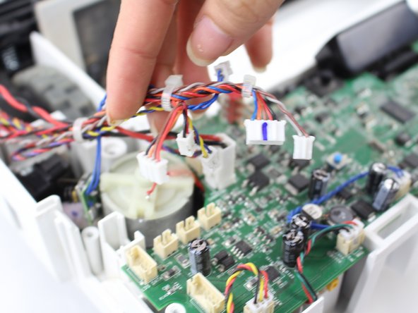

    • Push the clips, located in the back side, inward.
    • Gently lift up the top cover until you can see the wires. Then gently un-clip all the wires.
    • When you lift the top cover be careful because the wires are thin and fragile.

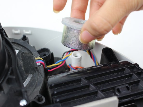

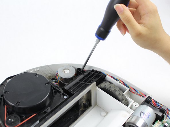

    • Locate the screws that mount the wheel extension to the Robot.
    • Unscrew the four 11mm screws indicated with a Torx T10 screwdriver to remove the frame.
    • Make sure to remove the metallic weight. However, this does not require the removal of any screws.

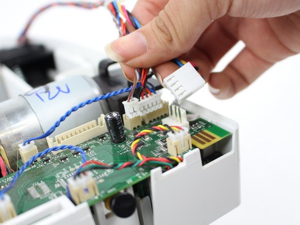

    • Delicately lift up the frame holding the laser. This will access the wheels.
    • Detach the wheel wires that are connected to the motherboard.
    • Once the wires are detached, the wheel are free from their casing.

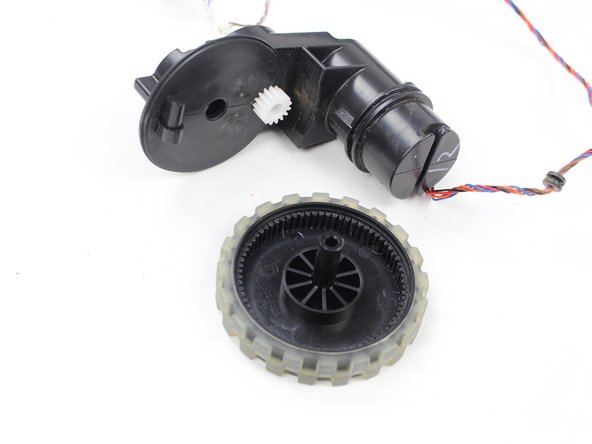

  13. Neato Botvac D8000 Wheel Replacement: crwdns2935265:013crwdnd2935265:01crwdnd2935265:02crwdne2935265:0 Neato Botvac D8000 Wheel Replacement: crwdns2935265:013crwdnd2935265:02crwdnd2935265:02crwdne2935265:0
    • Use a Torx T15 screwdriver to remove the 32.5mm screw.
    • Finally, just hold and separate the wheel from its axle.
