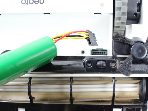

    • Turn the robot upside down to locate the battery cover.
  2. Neato Botvac D8000 Battery Replacement: crwdns2935265:02crwdnd2935265:01crwdnd2935265:03crwdne2935265:0 Neato Botvac D8000 Battery Replacement: crwdns2935265:02crwdnd2935265:02crwdnd2935265:03crwdne2935265:0 Neato Botvac D8000 Battery Replacement: crwdns2935265:02crwdnd2935265:03crwdnd2935265:03crwdne2935265:0
    • Use a Phillips #1 screwdriver to unscrew both of the 20mm screws.
    • Gently lift the battery cover.
    • Remove the battery cover to reveal the battery.

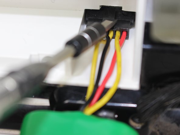

  3. Neato Botvac D8000 Battery Replacement: crwdns2935265:03crwdnd2935265:01crwdnd2935265:03crwdne2935265:0 Neato Botvac D8000 Battery Replacement: crwdns2935265:03crwdnd2935265:02crwdnd2935265:03crwdne2935265:0 Neato Botvac D8000 Battery Replacement: crwdns2935265:03crwdnd2935265:03crwdnd2935265:03crwdne2935265:0
    • Use a flathead screwdriver to push down on the latch of the battery clip.
    • Simultaneously, pull on the battery while pushing down on the latch to detach the battery from the clip.
    • Do not pull on the wires that are connected to the battery.
