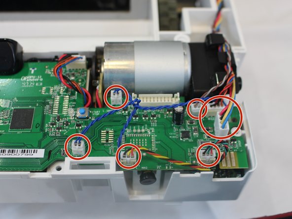

  15. Neato Botvac D75 Motherboard Replacement, Motherboard: crwdns2935265:015crwdnd2935265:01crwdnd2935265:03crwdne2935265:0 Neato Botvac D75 Motherboard Replacement, Motherboard: crwdns2935265:015crwdnd2935265:02crwdnd2935265:03crwdne2935265:0 Neato Botvac D75 Motherboard Replacement, Motherboard: crwdns2935265:015crwdnd2935265:03crwdnd2935265:03crwdne2935265:0
    • Carefully remove the plugs connected to top side of the motherboard.
    • Be careful to not pull the white casings that attach the plugs to the board.

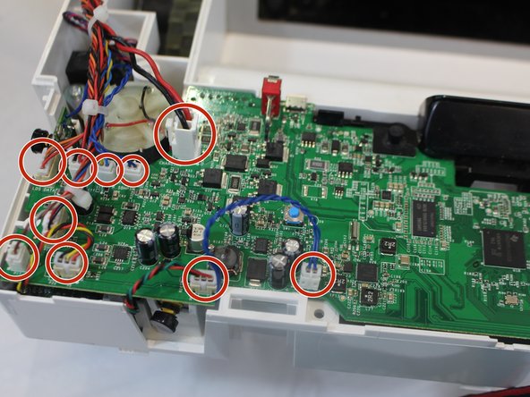

  16. Neato Botvac D75 Motherboard Replacement: crwdns2935265:016crwdnd2935265:01crwdnd2935265:01crwdne2935265:0
    • Remove the cables attached to the under side of the motherboard.
    • Similarly to the previous step, be careful as to not remove the casing attaching the cable to the board.
