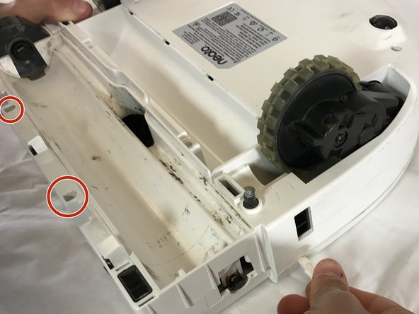

      • Once you have everything out get the plastic opening tool and pry open the large black plastic piece.
      • With a little force it should come out.
      • The boxes show you were the clips are that hold this piece
    3. Neato Botvac D75 LCD Screen Replacement: crwdns2935265:06crwdnd2935265:01crwdnd2935265:01crwdne2935265:0
      • Once the black piece has been taken out, the brush just comes out easily.

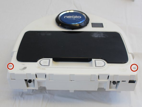

      • Firmly grasp the back cover and pull away from the Botvac one side at a time.
      • Removing the cover will expose two 1.3mm T10 screws that must be removed to separate the cover halves.
    2. Neato Botvac D75 LCD Screen Replacement: crwdns2935265:08crwdnd2935265:01crwdnd2935265:02crwdne2935265:0 Neato Botvac D75 LCD Screen Replacement: crwdns2935265:08crwdnd2935265:02crwdnd2935265:02crwdne2935265:0

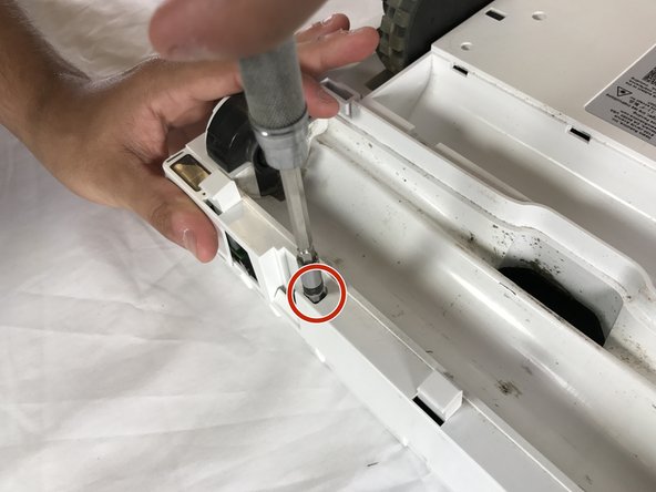

      • Remove these two 13mm T10 screws. You will need to use the extension in your tool set since they are deep in the casting.
    3. Neato Botvac D75 LCD Screen Replacement: crwdns2935265:09crwdnd2935265:01crwdnd2935265:02crwdne2935265:0 Neato Botvac D75 LCD Screen Replacement: crwdns2935265:09crwdnd2935265:02crwdnd2935265:02crwdne2935265:0

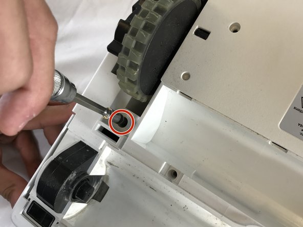

      • Eight 13mm T10 screws on the underside of the Botvac hold the casing together. These screws are not self-retained so make sure that you don’t lose them in the disassembly process.
    4. Neato Botvac D75 LCD Screen Replacement: crwdns2935265:010crwdnd2935265:01crwdnd2935265:03crwdne2935265:0 Neato Botvac D75 LCD Screen Replacement: crwdns2935265:010crwdnd2935265:02crwdnd2935265:03crwdne2935265:0 Neato Botvac D75 LCD Screen Replacement: crwdns2935265:010crwdnd2935265:03crwdnd2935265:03crwdne2935265:0
      • The screws pictured here on either side of the Botvac require the extension in your tool set to be removed.

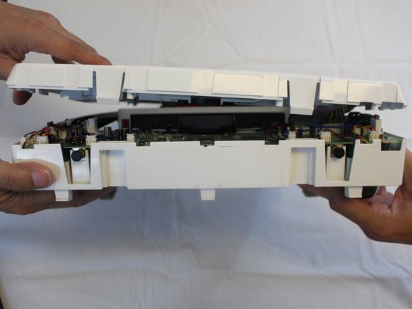

      • On the back of the Botvac there are two retaining tabs that must be pressed to be released.
      • With the tabs released the top and bottom cover halves can be separated.
    6. Neato Botvac D75 LCD Screen Replacement: crwdns2935265:012crwdnd2935265:01crwdnd2935265:03crwdne2935265:0 Neato Botvac D75 LCD Screen Replacement: crwdns2935265:012crwdnd2935265:02crwdnd2935265:03crwdne2935265:0 Neato Botvac D75 LCD Screen Replacement: crwdns2935265:012crwdnd2935265:03crwdnd2935265:03crwdne2935265:0

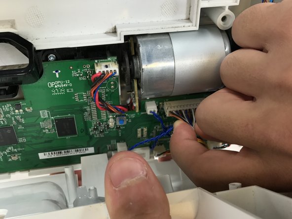

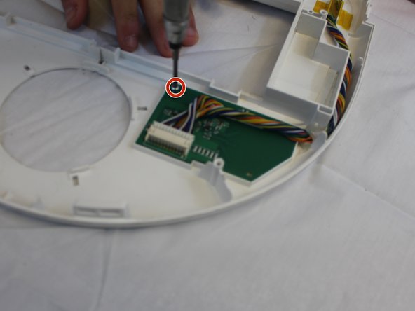

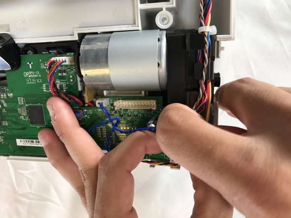

      • Carefully lift the top cover of the Botvac. On the right side of the Botvac is where you'll find the LCD screen connector to the motherboard. Carefully pull on the connector to disconnect it from the motherboard.
    7. Neato Botvac D75 LCD Screen Replacement: crwdns2935265:013crwdnd2935265:01crwdnd2935265:03crwdne2935265:0 Neato Botvac D75 LCD Screen Replacement: crwdns2935265:013crwdnd2935265:02crwdnd2935265:03crwdne2935265:0 Neato Botvac D75 LCD Screen Replacement: crwdns2935265:013crwdnd2935265:03crwdnd2935265:03crwdne2935265:0

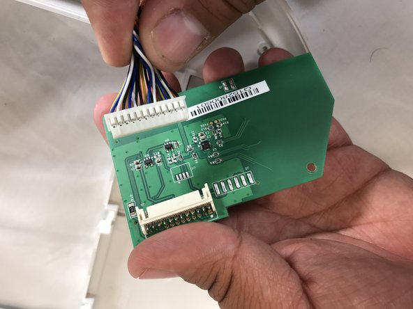

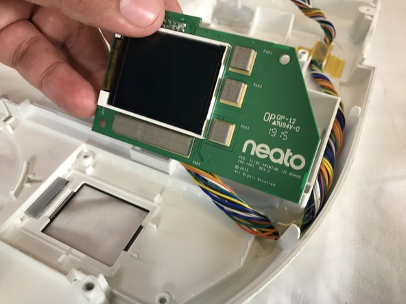

      • There are two 0.5cm #1 Phillips screws holding the LCD screen to the top cover. Remove these screws to lift screen off the cover.
    8. Neato Botvac D75 LCD Screen Replacement: crwdns2935265:014crwdnd2935265:01crwdnd2935265:03crwdne2935265:0 Neato Botvac D75 LCD Screen Replacement: crwdns2935265:014crwdnd2935265:02crwdnd2935265:03crwdne2935265:0 Neato Botvac D75 LCD Screen Replacement: crwdns2935265:014crwdnd2935265:03crwdnd2935265:03crwdne2935265:0

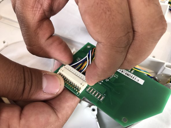

      • With the two screws removed you may lift the screen off the cover. Carefully remove the connector from the screen by pulling on the connector.
