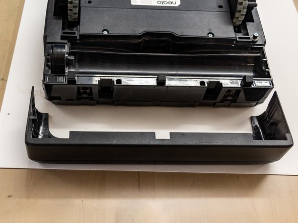

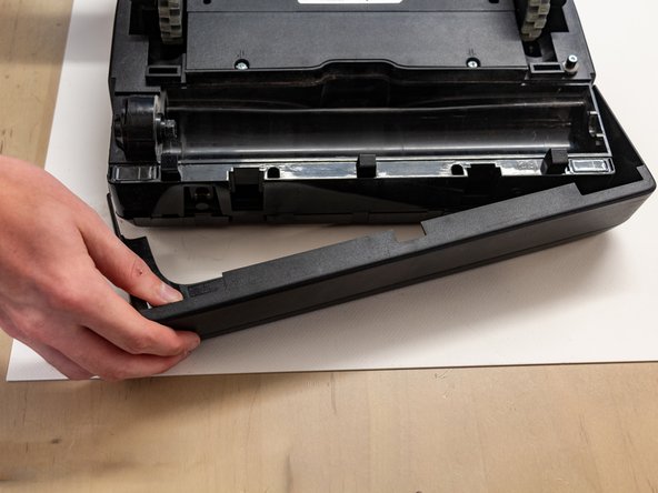

  3. Neato Botvac Connected Screen Replacement: crwdns2935265:03crwdnd2935265:01crwdnd2935265:03crwdne2935265:0 Neato Botvac Connected Screen Replacement: crwdns2935265:03crwdnd2935265:02crwdnd2935265:03crwdne2935265:0 Neato Botvac Connected Screen Replacement: crwdns2935265:03crwdnd2935265:03crwdnd2935265:03crwdne2935265:0
    • Pull one side of the front bumper out and then forward toward you. Repeat on the other side to completely detach the front bumper.

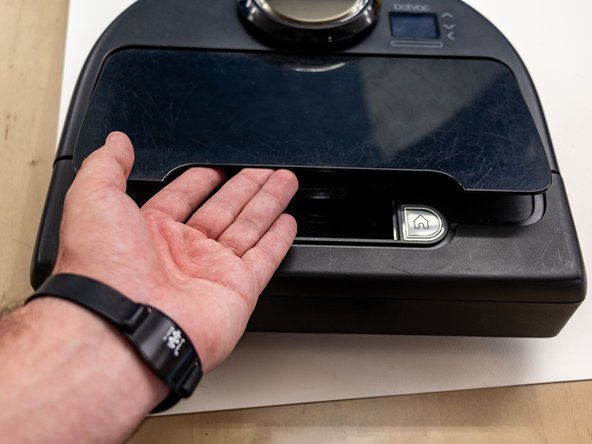

    • Remove the eight screws from the underside of the Botvac using a TR10 Torx screwdriver.
    • Remove the additional two TR10 screws from the top of the Botvac.
    • Remove the dustbin.

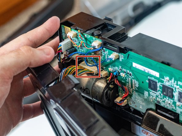

    • Pry the clips on the front of the robot apart.
    • Unplug the beige connector with a spudger, working one side at a time until it comes unplugged.
    • Make certain not to not to tear any wires out of the port.

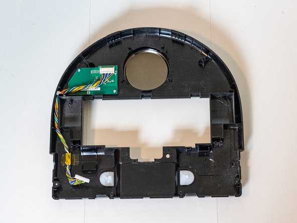

    • Lay the top of the robot inside up.
  6. Neato Botvac Connected Screen Replacement: crwdns2935265:06crwdnd2935265:01crwdnd2935265:02crwdne2935265:0 Neato Botvac Connected Screen Replacement: crwdns2935265:06crwdnd2935265:02crwdnd2935265:02crwdne2935265:0

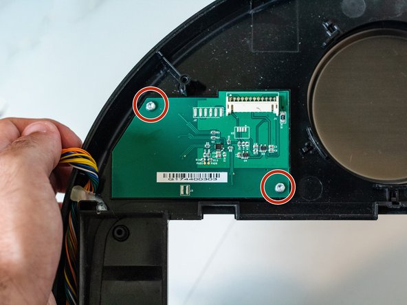

    • Unplug the beige connector with a spudger. Be careful not to tear out any wires.
    • Remove the two screws from the screen using a TR10 Torx screwdriver.
    • Remove the screen from the vacuum.
