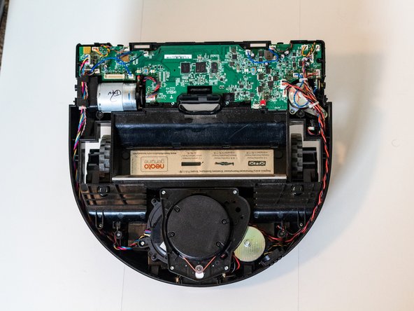

  2. Neato Botvac Connected Right Side Wall Sensor Replacement: crwdns2935265:02crwdnd2935265:01crwdnd2935265:01crwdne2935265:0
    • Remove the two screws behind the front roller of the robot using a Phillips #2 screwdriver.
    • Remove the battery by lifting it out while pressing down on the wire clip inside the compartment.

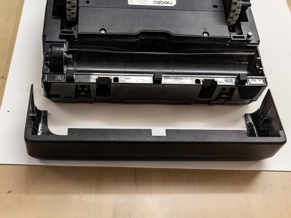

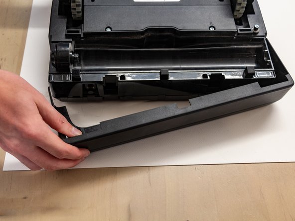

  3. Neato Botvac Connected Right Side Wall Sensor Replacement: crwdns2935265:03crwdnd2935265:01crwdnd2935265:03crwdne2935265:0 Neato Botvac Connected Right Side Wall Sensor Replacement: crwdns2935265:03crwdnd2935265:02crwdnd2935265:03crwdne2935265:0 Neato Botvac Connected Right Side Wall Sensor Replacement: crwdns2935265:03crwdnd2935265:03crwdnd2935265:03crwdne2935265:0
    • Pull one side of the front bumper out and then forward toward you. Repeat on the other side to completely detach the front bumper.

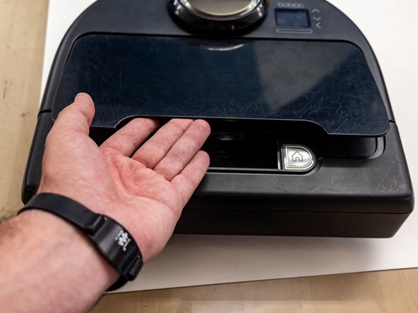

    • Remove the dustbin.

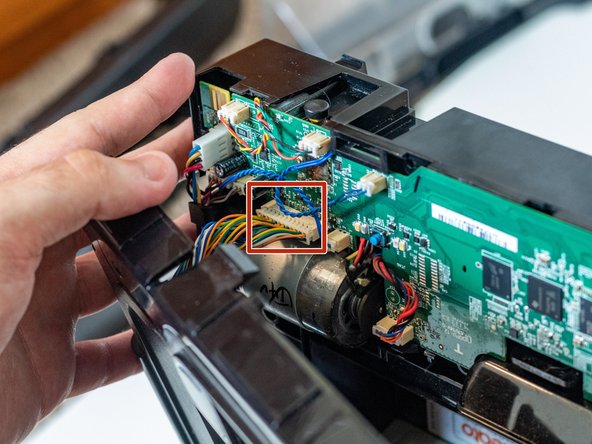

  5. Neato Botvac Connected Right Side Wall Sensor Replacement: crwdns2935265:05crwdnd2935265:01crwdnd2935265:03crwdne2935265:0 Neato Botvac Connected Right Side Wall Sensor Replacement: crwdns2935265:05crwdnd2935265:02crwdnd2935265:03crwdne2935265:0 Neato Botvac Connected Right Side Wall Sensor Replacement: crwdns2935265:05crwdnd2935265:03crwdnd2935265:03crwdne2935265:0
    • Pry the clips on the front of the robot apart.
    • Unplug the beige connector with a spudger, working one side at a time until it comes unplugged.
    • Make certain not to not to tear any wires out of the port.
