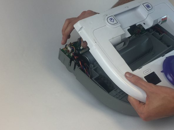

  5. Neato Botvac 80 Wheel Replacement: crwdns2935265:05crwdnd2935265:01crwdnd2935265:03crwdne2935265:0 Neato Botvac 80 Wheel Replacement: crwdns2935265:05crwdnd2935265:02crwdnd2935265:03crwdne2935265:0 Neato Botvac 80 Wheel Replacement: crwdns2935265:05crwdnd2935265:03crwdnd2935265:03crwdne2935265:0
    • To remove the top, you must press in both of the clamps at the same time and push upwards.
    • When removing the top, before you can completely take it off you must unplug the LCD power cable from the motherboard.

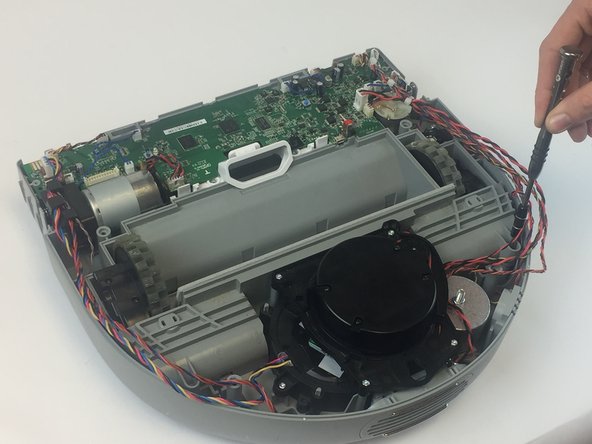

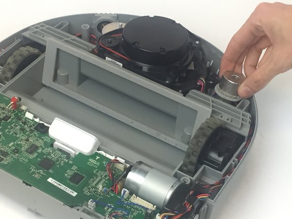

    • Locate the screws that mount the wheel extensions on the Botvac.
    • Unscrew the four 11mm screws and bolts indicated to remove the frame.
    • The metallic weight (as shown) does not require the removal of any screws. However, make sure to complete this before proceeding.
  7. Neato Botvac 80 Wheel Replacement: crwdns2935265:07crwdnd2935265:01crwdnd2935265:02crwdne2935265:0 Neato Botvac 80 Wheel Replacement: crwdns2935265:07crwdnd2935265:02crwdnd2935265:02crwdne2935265:0
    • Gently lift the frame holding the laser. This will free the wheels from their casing.

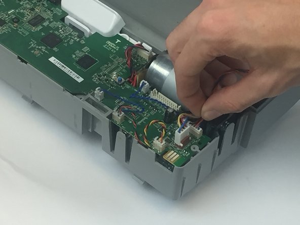

    • Remove the wheel's wires that are attached to the motherboard.
    • Once removed, you may now free the wheels.

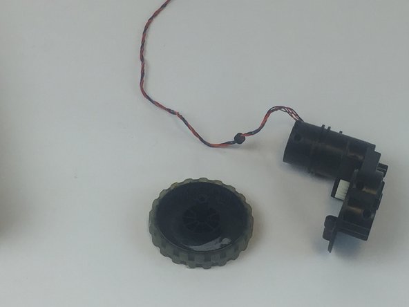

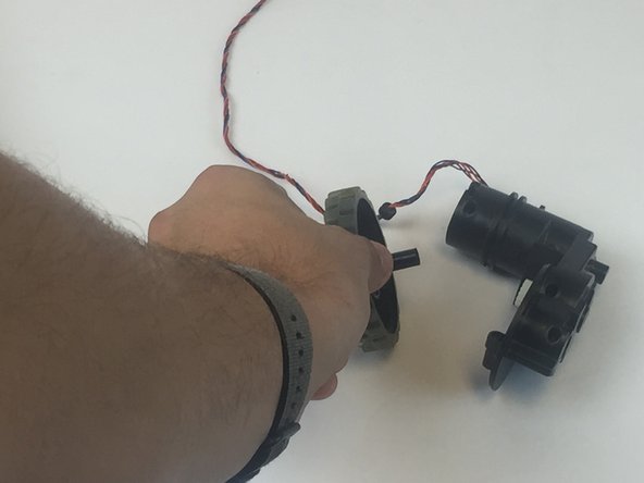

  8. Neato Botvac 80 Wheel Replacement: crwdns2935265:08crwdnd2935265:01crwdnd2935265:03crwdne2935265:0 Neato Botvac 80 Wheel Replacement: crwdns2935265:08crwdnd2935265:02crwdnd2935265:03crwdne2935265:0 Neato Botvac 80 Wheel Replacement: crwdns2935265:08crwdnd2935265:03crwdnd2935265:03crwdne2935265:0
    • Remove the wheel usings the T15, or similar, attachment to remove the 32.5mm screw.
    • Finally, just grab and separate the tire from its axle.
