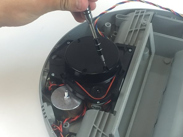

    1. Neato Botvac 80 Laser Replacement, Laser: crwdns2935265:06crwdnd2935265:01crwdnd2935265:03crwdne2935265:0 Neato Botvac 80 Laser Replacement, Laser: crwdns2935265:06crwdnd2935265:02crwdnd2935265:03crwdne2935265:0 Neato Botvac 80 Laser Replacement, Laser: crwdns2935265:06crwdnd2935265:03crwdnd2935265:03crwdne2935265:0
      • Lift gently upon the top panel.
      • Unplug the clip located on the right side before completely removing.
    2. Neato Botvac 80 Laser Replacement: crwdns2935265:07crwdnd2935265:01crwdnd2935265:03crwdne2935265:0 Neato Botvac 80 Laser Replacement: crwdns2935265:07crwdnd2935265:02crwdnd2935265:03crwdne2935265:0 Neato Botvac 80 Laser Replacement: crwdns2935265:07crwdnd2935265:03crwdnd2935265:03crwdne2935265:0
      • This black cap spins so may need a hand when unscrewing the screws.
      • Locate and unscrew the four 12 mm screws located in the black cap with the phillips #00 screwdriver.
      • Lift the black cap to reveal the laser.
    3. Neato Botvac 80 Laser Replacement: crwdns2935265:08crwdnd2935265:01crwdnd2935265:03crwdne2935265:0 Neato Botvac 80 Laser Replacement: crwdns2935265:08crwdnd2935265:02crwdnd2935265:03crwdne2935265:0 Neato Botvac 80 Laser Replacement: crwdns2935265:08crwdnd2935265:03crwdnd2935265:03crwdne2935265:0
      • There are two loosely secured black blinders on both the laser and sensor.
      • Gently pull back on the gold laser to remove it from the socket.
      • Unplug the mini LCU clip by gently pulling up and remove the laser.
