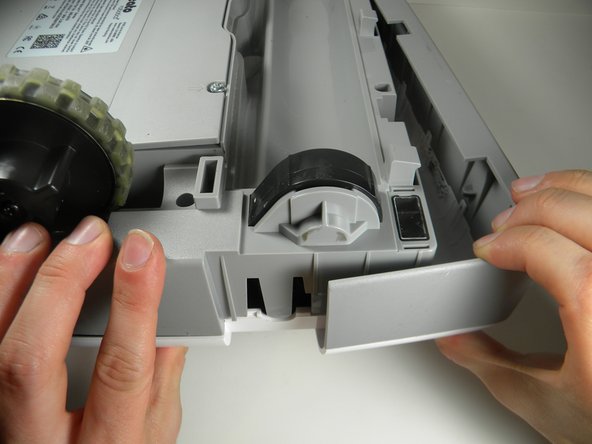

  7. Neato Botvac 65 Wheel Motors Replacement: crwdns2935265:07crwdnd2935265:01crwdnd2935265:02crwdne2935265:0 Neato Botvac 65 Wheel Motors Replacement: crwdns2935265:07crwdnd2935265:02crwdnd2935265:02crwdne2935265:0
    • Remove the plastic brush guard.
    • Pull off the plastic covering the brush.
  8. Neato Botvac 65 Wheel Motors Replacement: crwdns2935265:08crwdnd2935265:01crwdnd2935265:01crwdne2935265:0
    • Lift the brush to clean or replace.

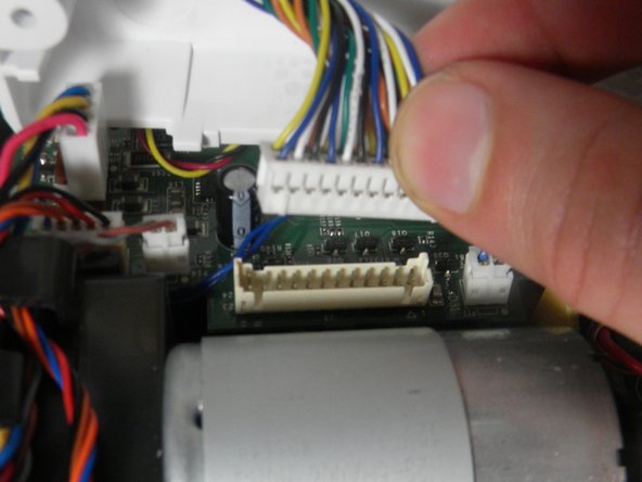

  13. Neato Botvac 65 Wheel Motors Replacement: crwdns2935265:013crwdnd2935265:01crwdnd2935265:02crwdne2935265:0 Neato Botvac 65 Wheel Motors Replacement: crwdns2935265:013crwdnd2935265:02crwdnd2935265:02crwdne2935265:0
    • Lift up on the top cover gently.
    • Disconnect the connector from the motherboard to detach the top cover from the robot.

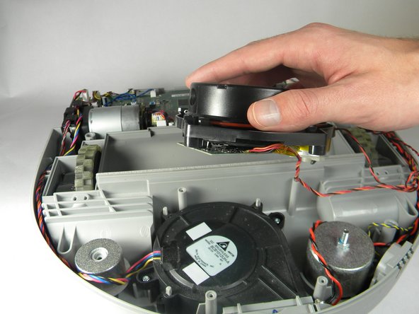

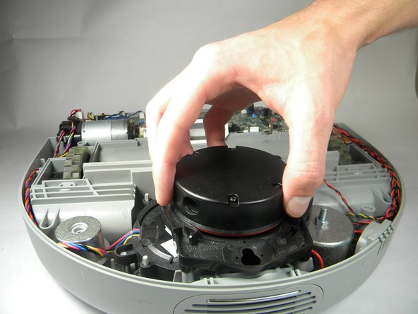

  14. Neato Botvac 65 Wheel Motors Replacement, Wheel Motors: crwdns2935265:014crwdnd2935265:01crwdnd2935265:03crwdne2935265:0 Neato Botvac 65 Wheel Motors Replacement, Wheel Motors: crwdns2935265:014crwdnd2935265:02crwdnd2935265:03crwdne2935265:0 Neato Botvac 65 Wheel Motors Replacement, Wheel Motors: crwdns2935265:014crwdnd2935265:03crwdnd2935265:03crwdne2935265:0
    • Remove four (4) 10mm 'star' screws using the T10 bit from the base plate where the rotating infrared sensor is located.
    • Carefully place the sensor on or near the robot without pulling the wires out.
  15. Neato Botvac 65 Wheel Motors Replacement: crwdns2935265:015crwdnd2935265:01crwdnd2935265:01crwdne2935265:0
    • Remove two (2) screws using the T10 bit that connects the plastic protector over the wheel motor.
    • Pull up on the metal weight to remove.

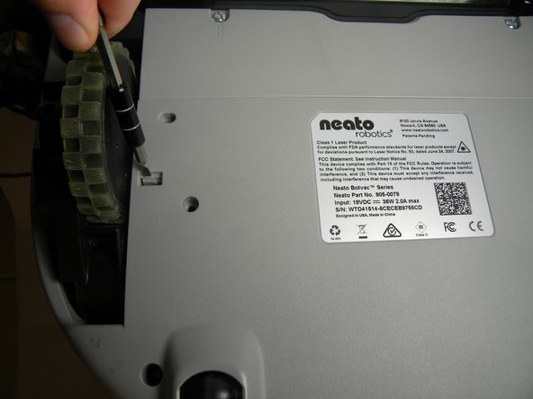

  16. Neato Botvac 65 Wheel Motors Replacement: crwdns2935265:016crwdnd2935265:01crwdnd2935265:02crwdne2935265:0 Neato Botvac 65 Wheel Motors Replacement: crwdns2935265:016crwdnd2935265:02crwdnd2935265:02crwdne2935265:0
    • Flip the botvac over being careful not to drop the IR sensor or cause damage to the wires.
    • Using a flat-head screw driver and a cloth for protection, press on the clips until they recede into the botvac.

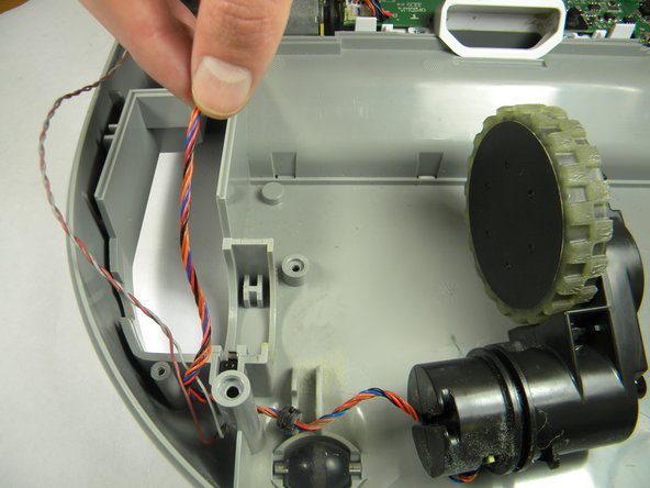

  17. Neato Botvac 65 Wheel Motors Replacement: crwdns2935265:017crwdnd2935265:01crwdnd2935265:02crwdne2935265:0 Neato Botvac 65 Wheel Motors Replacement: crwdns2935265:017crwdnd2935265:02crwdnd2935265:02crwdne2935265:0
    • Flip the robot back over(right-side up).
    • Carefully remove the plastic cover that protects the motor.

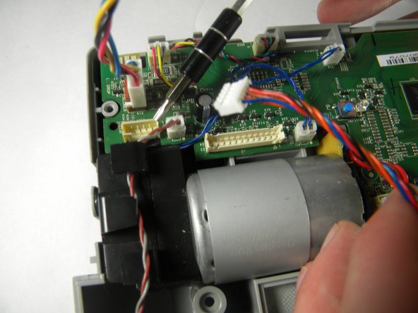

  18. Neato Botvac 65 Wheel Motors Replacement: crwdns2935265:018crwdnd2935265:01crwdnd2935265:03crwdne2935265:0 Neato Botvac 65 Wheel Motors Replacement: crwdns2935265:018crwdnd2935265:02crwdnd2935265:03crwdne2935265:0 Neato Botvac 65 Wheel Motors Replacement: crwdns2935265:018crwdnd2935265:03crwdnd2935265:03crwdne2935265:0
    • Carefully remove the motor that you wish to replace.
    • Trace the wires that are connected to the motor back to the motherboard.
    • Disconnect the connector from the motherboard for the respective motor you're replacing.
