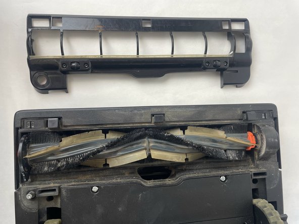

  3. Neato BOTVAC D5 Main Roller Brush Replacement, Main Roller Brush: crwdns2935265:03crwdnd2935265:01crwdnd2935265:02crwdne2935265:0 Neato BOTVAC D5 Main Roller Brush Replacement, Main Roller Brush: crwdns2935265:03crwdnd2935265:02crwdnd2935265:02crwdne2935265:0
    • Pop the tabs shown on the main brush cover, and then pull. It should come right off. You can put it aside for now.

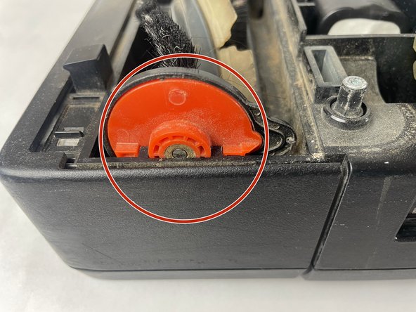

  4. Neato BOTVAC D5 Main Roller Brush Replacement: crwdns2935265:04crwdnd2935265:01crwdnd2935265:02crwdne2935265:0 Neato BOTVAC D5 Main Roller Brush Replacement: crwdns2935265:04crwdnd2935265:02crwdnd2935265:02crwdne2935265:0
    • The Main brush will pop right out when you attempt to remove it.
    • When replacing the main brush make sure to orient it correctly.
