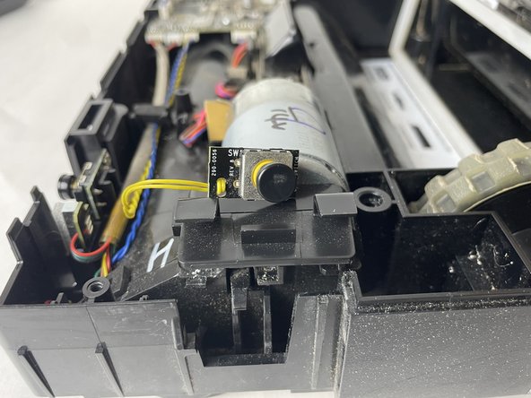

  5. Neato BOTVAC D5 Main Brush Motor Replacement, Main Brush Motor: crwdns2935265:05crwdnd2935265:01crwdnd2935265:02crwdne2935265:0 Neato BOTVAC D5 Main Brush Motor Replacement, Main Brush Motor: crwdns2935265:05crwdnd2935265:02crwdnd2935265:02crwdne2935265:0
    • Pull down the latch under the sensor and then carefully remove it from the unit.
  6. Neato BOTVAC D5 Main Brush Motor Replacement: crwdns2935265:06crwdnd2935265:01crwdnd2935265:02crwdne2935265:0 Neato BOTVAC D5 Main Brush Motor Replacement: crwdns2935265:06crwdnd2935265:02crwdnd2935265:02crwdne2935265:0
    • Flip the unit over and locate the gap next to the motor, on the same side the sensor was removed from. Insert your flathead screwdriver and twist lightly to pop off the motor.
  7. Neato BOTVAC D5 Main Brush Motor Replacement: crwdns2935265:07crwdnd2935265:01crwdnd2935265:01crwdne2935265:0
    • Disconnect the wiring connecting the motor to the circuit board and remove the brush motor.
