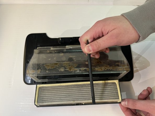

  15. Neato BOTVAC CONNECTED Side Wheel Replacement: crwdns2935265:015crwdnd2935265:01crwdnd2935265:01crwdne2935265:0
    • Gently remove the front panel by opening it with a spudger.
  16. Neato BOTVAC CONNECTED Side Wheel Replacement: crwdns2935265:016crwdnd2935265:01crwdnd2935265:02crwdne2935265:0 Neato BOTVAC CONNECTED Side Wheel Replacement: crwdns2935265:016crwdnd2935265:02crwdnd2935265:02crwdne2935265:0
    • Use the spudger to gently remove the paper filter.

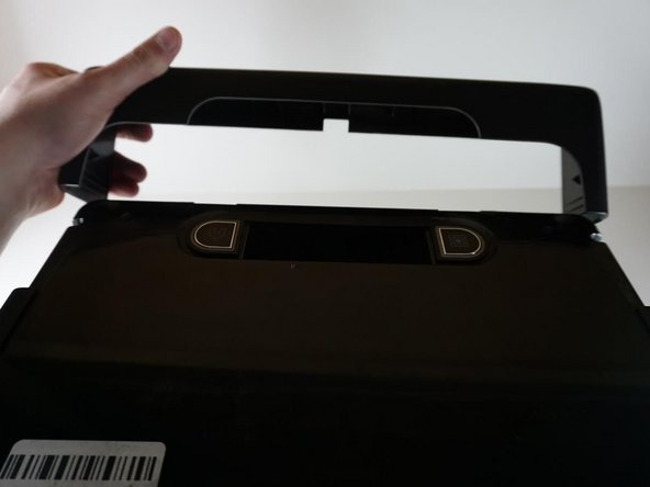

  18. Neato BOTVAC CONNECTED Side Wheel Replacement: crwdns2935265:018crwdnd2935265:01crwdnd2935265:02crwdne2935265:0 Neato BOTVAC CONNECTED Side Wheel Replacement: crwdns2935265:018crwdnd2935265:02crwdnd2935265:02crwdne2935265:0
    • Remove the front bumper by pulling it horizontally on each side.

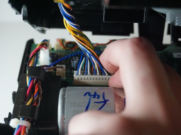

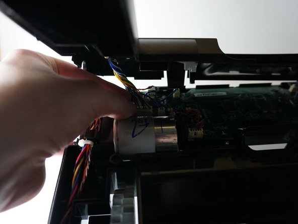

  22. Neato BOTVAC CONNECTED Side Wheel Replacement: crwdns2935265:022crwdnd2935265:01crwdnd2935265:03crwdne2935265:0 Neato BOTVAC CONNECTED Side Wheel Replacement: crwdns2935265:022crwdnd2935265:02crwdnd2935265:03crwdne2935265:0 Neato BOTVAC CONNECTED Side Wheel Replacement: crwdns2935265:022crwdnd2935265:03crwdnd2935265:03crwdne2935265:0
    • Gently take out the top panel, and take out the connecting wires.
