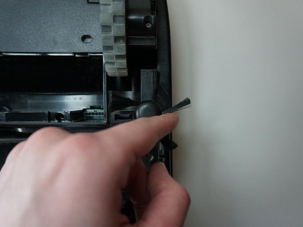

  11. Neato BOTVAC CONNECTED Side Brush Replacement, Side Brush: crwdns2935265:011crwdnd2935265:01crwdnd2935265:02crwdne2935265:0 Neato BOTVAC CONNECTED Side Brush Replacement, Side Brush: crwdns2935265:011crwdnd2935265:02crwdnd2935265:02crwdne2935265:0
    • Gently twist the side brush back and forth.

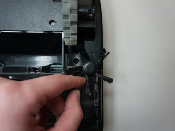

  12. Neato BOTVAC CONNECTED Side Brush Replacement: crwdns2935265:012crwdnd2935265:01crwdnd2935265:03crwdne2935265:0 Neato BOTVAC CONNECTED Side Brush Replacement: crwdns2935265:012crwdnd2935265:02crwdnd2935265:03crwdne2935265:0 Neato BOTVAC CONNECTED Side Brush Replacement: crwdns2935265:012crwdnd2935265:03crwdnd2935265:03crwdne2935265:0
    • Spin the side brush counter counterclockwise.

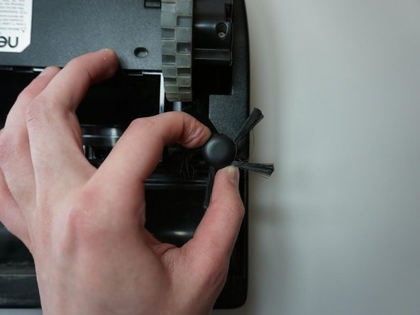

  13. Neato BOTVAC CONNECTED Side Brush Replacement: crwdns2935265:013crwdnd2935265:01crwdnd2935265:01crwdne2935265:0
    • Use the spudger to gently pry up and remove the side brush.
