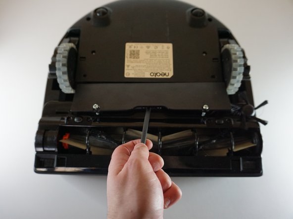

    • Place the top of the Neato Botvac Connected against a flat surface.
  2. Neato BOTVAC CONNECTED Front Roller Brush Replacement: crwdns2935265:02crwdnd2935265:01crwdnd2935265:02crwdne2935265:0 Neato BOTVAC CONNECTED Front Roller Brush Replacement: crwdns2935265:02crwdnd2935265:02crwdnd2935265:02crwdne2935265:0
    • Remove the two 5.5 mm screws with a Phillips #2 screwdriver.
  3. Neato BOTVAC CONNECTED Front Roller Brush Replacement: crwdns2935265:03crwdnd2935265:01crwdnd2935265:02crwdne2935265:0 Neato BOTVAC CONNECTED Front Roller Brush Replacement: crwdns2935265:03crwdnd2935265:02crwdnd2935265:02crwdne2935265:0
    • Using the spudger, remove the panel covering the battery.

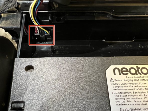

    • Gently remove the connecting wires attached to the battery.
    • The wires are attached to the vacuum through a clip.
  5. Neato BOTVAC CONNECTED Front Roller Brush Replacement: crwdns2935265:05crwdnd2935265:01crwdnd2935265:01crwdne2935265:0
    • Using the spudger, gently remove the battery from the device.

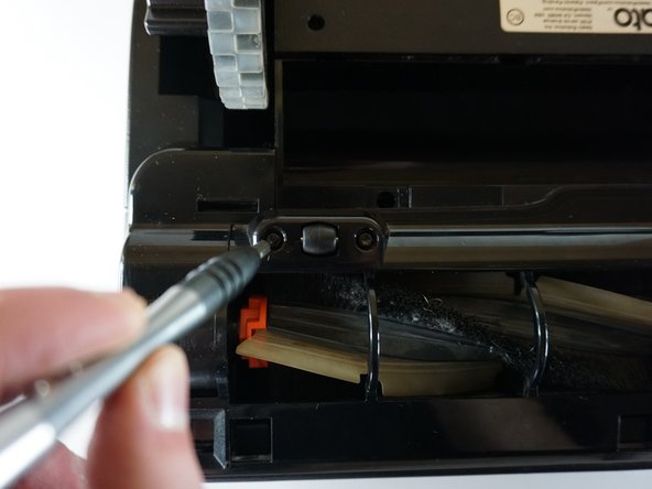

    • Remove the following screws with a Torx screwdriver:
    • Four 2.3 mm screws.
  7. Neato BOTVAC CONNECTED Front Roller Brush Replacement: crwdns2935265:07crwdnd2935265:01crwdnd2935265:01crwdne2935265:0
    • Gently remove the thin panel held by the four screws with a spudger.
