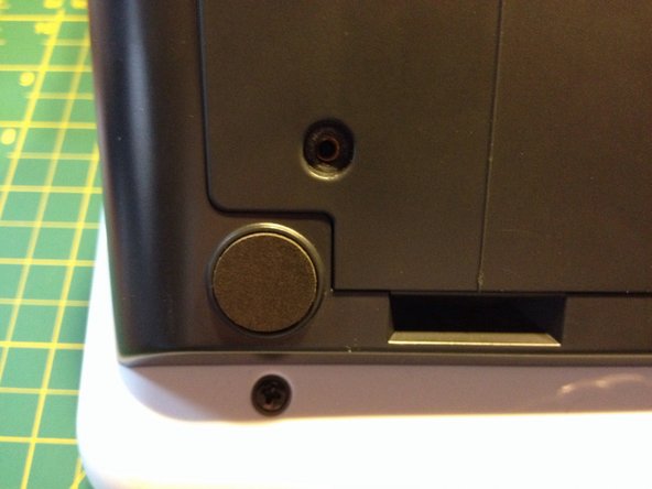

    • Unscrew bottom access cover.
    • Use a #2 Phillips Screwdriver and carefully remove Four (4) screws from bottom access panel.
    • It may be advisable to have a magnet handy, in the event the screws are difficult to extract due to the recessed mounting hole.
    • Open bottom access cover.
    • Use a Spudger or Suction Cup to pry open the access cover. Pay attention to provided image and be sure to tilt cover as shown to make removal easy.
    • Circuit board is mounted to other side of access cover and wiring must be disconnected before access cover is completely removed.

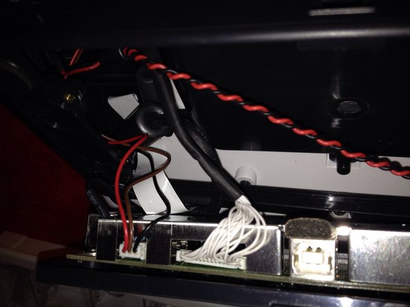

  3. NeatDesk™ Desktop Scanner Circuit Board Repair, Disconnect Wiring: crwdns2935265:03crwdnd2935265:01crwdnd2935265:03crwdne2935265:0 NeatDesk™ Desktop Scanner Circuit Board Repair, Disconnect Wiring: crwdns2935265:03crwdnd2935265:02crwdnd2935265:03crwdne2935265:0 NeatDesk™ Desktop Scanner Circuit Board Repair, Disconnect Wiring: crwdns2935265:03crwdnd2935265:03crwdnd2935265:03crwdne2935265:0
    • Disconnect screwed on wires from circuit board.
    • Use a #2 Phillips Screwdriver and carefully remove Two (2) screws that are securing ground wires to circuit board shield/mounting holes. See image for locations.
    • Use caution so not to drop or loose screws as they are removed. It is advised to have a magnet nearby and cover areas where screws may fall into.

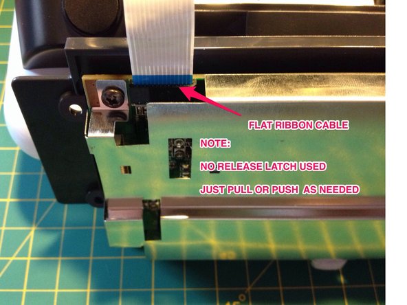

    • Disconnect plugged in connectors and flat ribbon cable.
    • Use a suitable pair of pliers, such as small needle nose and carefully grasp connectors then gently unplug in the sequence shown for easy access.
    • Use caution when handling flat ribbon cable to avoid cuts, bends or any damage to conductors.

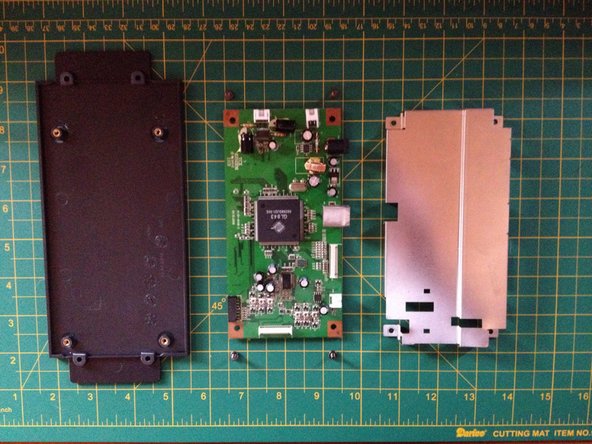

  4. NeatDesk™ Desktop Scanner Circuit Board Repair, Expose Circuit Board: crwdns2935265:04crwdnd2935265:01crwdnd2935265:03crwdne2935265:0 NeatDesk™ Desktop Scanner Circuit Board Repair, Expose Circuit Board: crwdns2935265:04crwdnd2935265:02crwdnd2935265:03crwdne2935265:0 NeatDesk™ Desktop Scanner Circuit Board Repair, Expose Circuit Board: crwdns2935265:04crwdnd2935265:03crwdnd2935265:03crwdne2935265:0
    • Use a #2 Phillips Screwdriver and carefully remove Four (4) screws from shield / circuit board mounting holes.
    • Be sure to exercise ESD ( Electro Static Discharge ) best practices.
    • Use an anti-static mat and wrist strap to avoid damaging sensitive electronic components of circuit board.

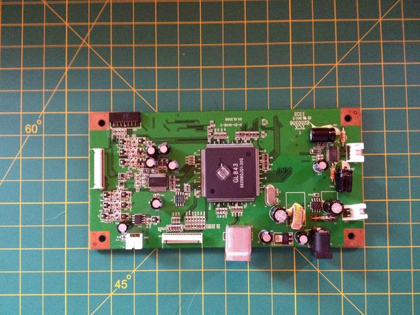

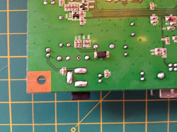

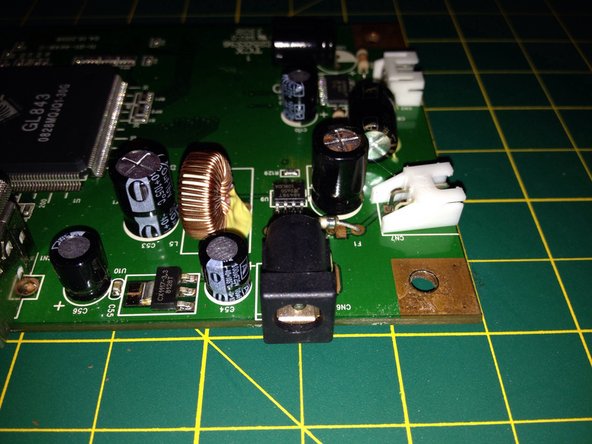

  5. NeatDesk™ Desktop Scanner Circuit Board Repair, Examine Circuit Board: crwdns2935265:05crwdnd2935265:01crwdnd2935265:03crwdne2935265:0 NeatDesk™ Desktop Scanner Circuit Board Repair, Examine Circuit Board: crwdns2935265:05crwdnd2935265:02crwdnd2935265:03crwdne2935265:0 NeatDesk™ Desktop Scanner Circuit Board Repair, Examine Circuit Board: crwdns2935265:05crwdnd2935265:03crwdnd2935265:03crwdne2935265:0

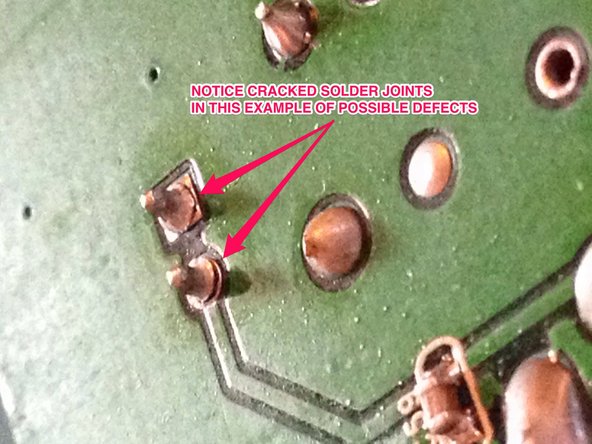

    • Carefully examine circuit board and all components, closely using good lighting and a magnifier.
    • Look for defects such as: Cracks, Burn Marks, Signs of Corrosion, Swollen Components, Unusual Looking Solder Joints ...
    • See pictures for example of Solder Joint Defect from this project.

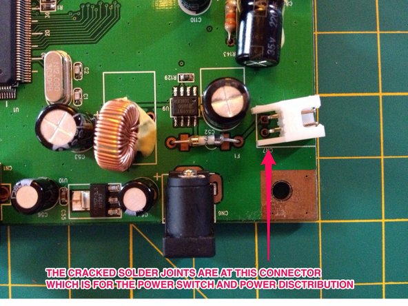

    • Note that the defective solder joints were likely a factory flaw that eventually gave out or were caused by strain, due to too short of wiring as visible by connector angle.
    • See Step 3 for likely cause of strain on connector that resulted in fatigued solder joints. ( Ref: Exhibit - 1 )
  6. NeatDesk™ Desktop Scanner Circuit Board Repair, Test Circuit Board: crwdns2935265:06crwdnd2935265:01crwdnd2935265:03crwdne2935265:0 NeatDesk™ Desktop Scanner Circuit Board Repair, Test Circuit Board: crwdns2935265:06crwdnd2935265:02crwdnd2935265:03crwdne2935265:0 NeatDesk™ Desktop Scanner Circuit Board Repair, Test Circuit Board: crwdns2935265:06crwdnd2935265:03crwdnd2935265:03crwdne2935265:0
    • Verify the power path is complete by using a multimeter on continuity mode and check "point to point" starting at the incoming power connector to the next available point. Continue as needed to verify there are no breaks in the circuit path.
    • Being this example was of a power related problem, it is advisable to check there are not any other issues that could disturb power flow.
    • In this example it was found that not only the solder joints had defects, but the fuse was open ( Likely due to power surge from poor connections )

    • Look at these images and note how a wire can easily be pinched or damaged, resulting in a New Problem. Do you see the Red Wire in a mounting hole path ?
    • Follow applicable sections of this guide in reverse as needed.
    • NOTE: Did you take pictures during your disassembly ?
