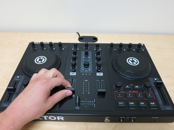

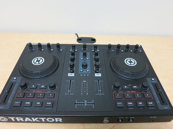

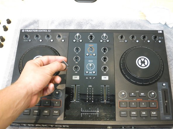

    • To start the disassembly, grab the channel fader slider and pull up. It will separate from the fader slide with ease.
    • Repeat previous instruction for the 5 other faders. Perform in this order: other channel fader, cross fader (the bottom fader in the middle), and the tempo faders (2 of them) on the left and right sides of the instrument.
    • Be firm, yet gentle when pulling up on the sliders.
  2. Native Instruments Traktor Kontrol S2 MK1: Disassembly and Jog Wheel Replacement: crwdns2935265:02crwdnd2935265:01crwdnd2935265:03crwdne2935265:0 Native Instruments Traktor Kontrol S2 MK1: Disassembly and Jog Wheel Replacement: crwdns2935265:02crwdnd2935265:02crwdnd2935265:03crwdne2935265:0 Native Instruments Traktor Kontrol S2 MK1: Disassembly and Jog Wheel Replacement: crwdns2935265:02crwdnd2935265:03crwdnd2935265:03crwdne2935265:0
    • To remove the knobs on the controller use a flat-head screwdriver and a cloth. There are 3 different kinds of knobs (effect, browsing, and level adjustment knobs).
    • Place the cloth in the small gap between the knob and the surface of the controller.
    • Insert the flat-head screwdriver under the knob using the cloth as a protector for the surface of the controller.
    • Acting as a lever, use the screwdriver to pry the knob up and away from the controller.
    • Set the knob aside or into a bag for safe keeping.
    • Repeat with the remaining knobs on the controller.

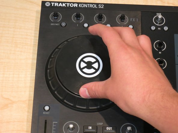

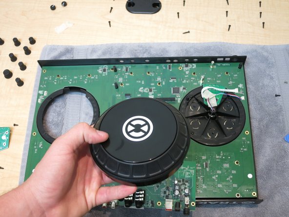

  3. Native Instruments Traktor Kontrol S2 MK1: Disassembly and Jog Wheel Replacement: crwdns2935265:03crwdnd2935265:01crwdnd2935265:03crwdne2935265:0 Native Instruments Traktor Kontrol S2 MK1: Disassembly and Jog Wheel Replacement: crwdns2935265:03crwdnd2935265:02crwdnd2935265:03crwdne2935265:0 Native Instruments Traktor Kontrol S2 MK1: Disassembly and Jog Wheel Replacement: crwdns2935265:03crwdnd2935265:03crwdnd2935265:03crwdne2935265:0
    • To remove the jog wheel cover, use your non-dominant hand to hold the jog wheel in place. With your dominant hand, press the top of the jog wheel and turn clockwise. The top should come off the jog wheel with ease.
    • Place jog wheel cover off to the side or in a bag.
    • Repeat with the remaining jog wheel.

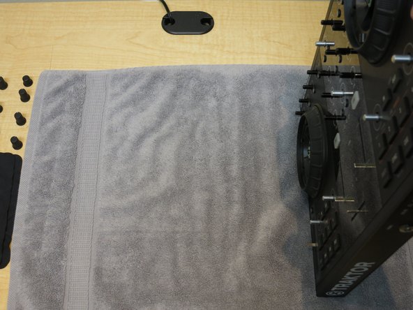

    • Checkpoint 1 - Make sure all your pieces are together to eliminate the potential for misplacement. Laying them out, or in a bag will help keep your controller pieces together.
    • To prep for further disassembly, place the towel on your workstation surface, laying evenly.

    • Gently flip the controller so the front of the controller is laying on the towel.

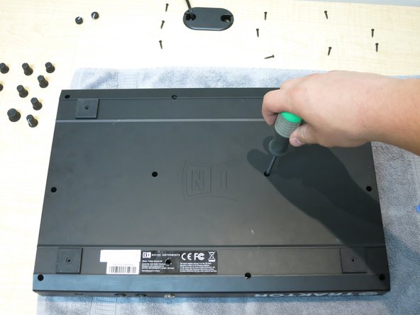

  6. Native Instruments Traktor Kontrol S2 MK1: Disassembly and Jog Wheel Replacement: crwdns2935265:06crwdnd2935265:01crwdnd2935265:03crwdne2935265:0 Native Instruments Traktor Kontrol S2 MK1: Disassembly and Jog Wheel Replacement: crwdns2935265:06crwdnd2935265:02crwdnd2935265:03crwdne2935265:0 Native Instruments Traktor Kontrol S2 MK1: Disassembly and Jog Wheel Replacement: crwdns2935265:06crwdnd2935265:03crwdnd2935265:03crwdne2935265:0

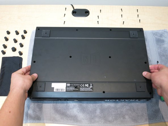

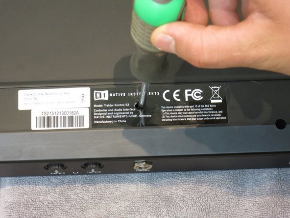

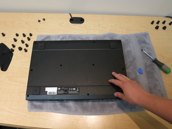

    • To access the internal components, remove the back of the controller.

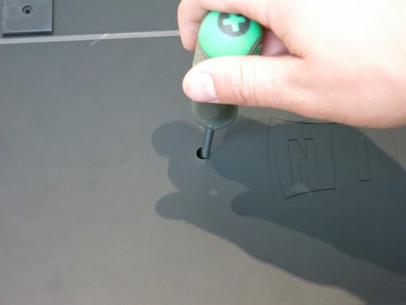

    • Using a philips-head screwdriver, unscrew the 12 screws that secure the back of the controller.
    • One out of the twelve screws is covered by a label. The easiest way to remove this particular screw is by removing the label first.
    • These screws are all the same size, be sure to keep them together.

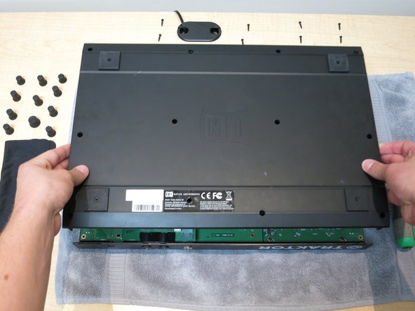

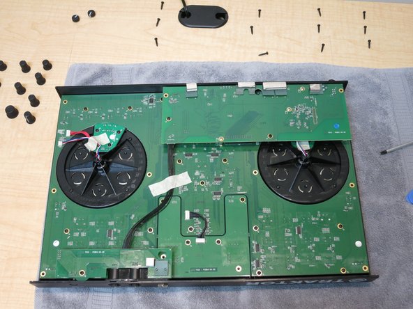

  8. Native Instruments Traktor Kontrol S2 MK1: Disassembly and Jog Wheel Replacement: crwdns2935265:08crwdnd2935265:01crwdnd2935265:03crwdne2935265:0 Native Instruments Traktor Kontrol S2 MK1: Disassembly and Jog Wheel Replacement: crwdns2935265:08crwdnd2935265:02crwdnd2935265:03crwdne2935265:0 Native Instruments Traktor Kontrol S2 MK1: Disassembly and Jog Wheel Replacement: crwdns2935265:08crwdnd2935265:03crwdnd2935265:03crwdne2935265:0
    • Next, remove the back plate of the controller. Simply grab the edges of both ends of the controller and lift up.

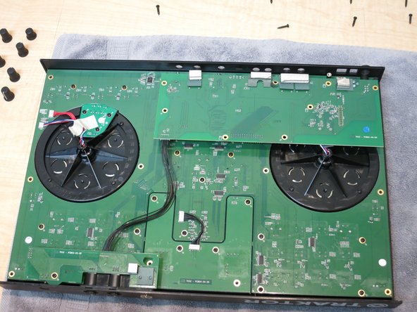

  9. Native Instruments Traktor Kontrol S2 MK1: Disassembly and Jog Wheel Replacement: crwdns2935265:09crwdnd2935265:01crwdnd2935265:01crwdne2935265:0

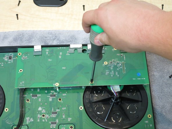

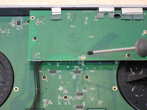

    • The sound card of the instrument will be removed next. Locate the rectangle board in the top right of the view before proceeding to disassembly instructions detailed in steps 10 and 11.
  10. Native Instruments Traktor Kontrol S2 MK1: Disassembly and Jog Wheel Replacement: crwdns2935265:010crwdnd2935265:01crwdnd2935265:02crwdne2935265:0 Native Instruments Traktor Kontrol S2 MK1: Disassembly and Jog Wheel Replacement: crwdns2935265:010crwdnd2935265:02crwdnd2935265:02crwdne2935265:0
    • Using the same philips-head screwdriver from previous steps, unscrew the 2 black screws and 3 silver screws that secure the sound card to the motherboard.

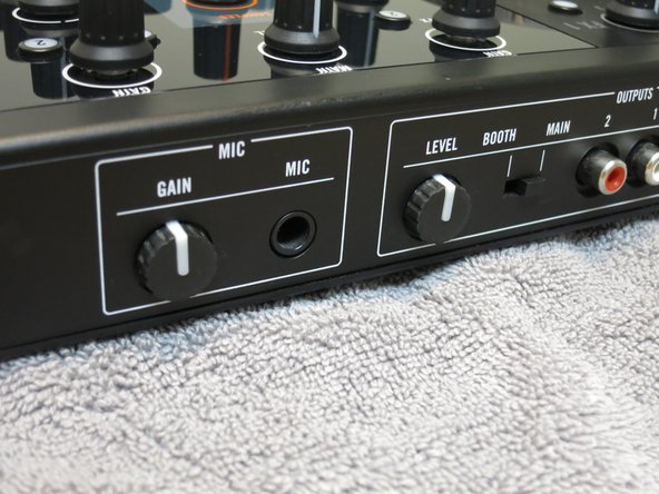

  11. Native Instruments Traktor Kontrol S2 MK1: Disassembly and Jog Wheel Replacement: crwdns2935265:011crwdnd2935265:01crwdnd2935265:02crwdne2935265:0 Native Instruments Traktor Kontrol S2 MK1: Disassembly and Jog Wheel Replacement: crwdns2935265:011crwdnd2935265:02crwdnd2935265:02crwdne2935265:0
    • Before removing the sound card, the 2 gain knobs in the back of the unit will need to be removed. Using a spudger tool, a guitar pick, or a small flat-head screwdriver to gently pry the knob from the unit.

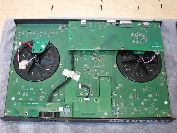

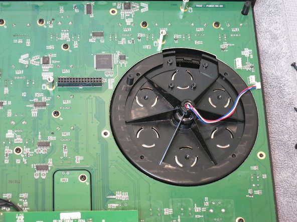

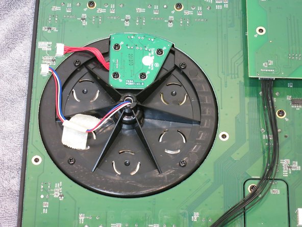

    • The right jog wheel (on the left side in the current view) will be disassembled next, and removed from the unit.

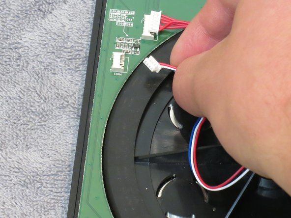

    • First, the two wires connecting to the jog wheel unit and the jog wheel sensor will need to be disconnected before removing the jog wheel.
    • Remove the masking tape holding down the red/white/blue cord bundle to the jog wheel unit.
    • Using your fingernail, carefully separate the red/white/blue cord from the motherboard connection site.
    • Do not pull by the plug, this will damage the cord and compromise the controller. Instead, gently pull the cord away by the white plug cap.
    • Repeat the same step with the red cord bundle.

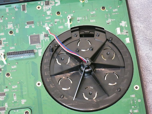

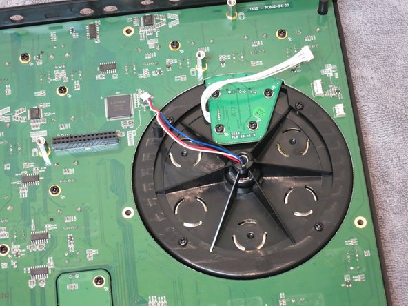

  13. Native Instruments Traktor Kontrol S2 MK1: Disassembly and Jog Wheel Replacement: crwdns2935265:013crwdnd2935265:01crwdnd2935265:02crwdne2935265:0 Native Instruments Traktor Kontrol S2 MK1: Disassembly and Jog Wheel Replacement: crwdns2935265:013crwdnd2935265:02crwdnd2935265:02crwdne2935265:0

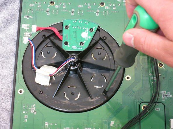

    • Using the philips-head screwdriver, unscrew the four black screws that are on the jog wheel unit. They will be on the outer edges of the circle.
    • Next, unscrew the 4 screws that secure the jog wheel sensor to the controller.
    • Set all screws and the electronic sensor in a safe place/aside
  14. Native Instruments Traktor Kontrol S2 MK1: Disassembly and Jog Wheel Replacement: crwdns2935265:014crwdnd2935265:01crwdnd2935265:01crwdne2935265:0
    • Gently raise the controller body. The jog wheel (now separated) will still be laying on the towel.
    • Set jog wheel aside (for discarding, recycling, or reassembly).

  15. Native Instruments Traktor Kontrol S2 MK1: Disassembly and Jog Wheel Replacement: crwdns2935265:015crwdnd2935265:01crwdnd2935265:03crwdne2935265:0 Native Instruments Traktor Kontrol S2 MK1: Disassembly and Jog Wheel Replacement: crwdns2935265:015crwdnd2935265:02crwdnd2935265:03crwdne2935265:0 Native Instruments Traktor Kontrol S2 MK1: Disassembly and Jog Wheel Replacement: crwdns2935265:015crwdnd2935265:03crwdnd2935265:03crwdne2935265:0

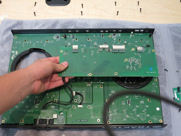

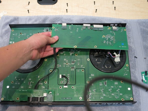

    • For this step, grab both sides of the sound card and carefully bring it straight up for removal. There are small metal prongs on the bottom of the sound card that connect with the motherboard. To eliminate the possibility of damaging the prongs, it is pertinent that the sound card is not removed on an angle.
  16. Native Instruments Traktor Kontrol S2 MK1: Disassembly and Jog Wheel Replacement: crwdns2935265:016crwdnd2935265:01crwdnd2935265:01crwdne2935265:0
    • Fold over the sound card, and then place the sound card on the bottom of the board.
    • When moving the sound card make sure it is very close to the unit. The wires are still connected. Any pulling or stretching on these wires can cause damage to the unit or sound card.
    • A picture of the new location of the sound card can be found at Step 17.

    • To install a replacement jog wheel, the first step is to connect the left jog wheel (viewed as right on the controller) into the empty slot.
    • Next, align the screw holes on the jog wheel unit with the holes of the jog wheel frame.
    • Now that the holes are aligned, you are going to need 4 black screws. Using a philips head screwdriver, screw the 4 black screws into the jog wheel unit.
    • After that is done, place the polygon-shaped reader back on to the unit, and screw in the other 4 black screws using the philips-head screwdriver.
    • Then gently plug in the red, white, and blue wire bundle, along with the red bundle into their respective spot on the motherboard.
