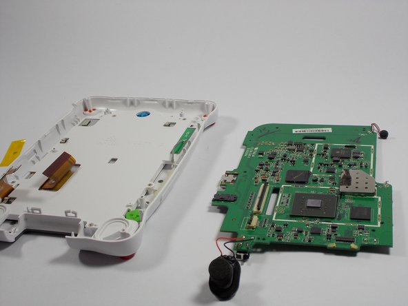

  5. Nabi Jr Screen Replacement, Motherboard: crwdns2935265:05crwdnd2935265:01crwdnd2935265:01crwdne2935265:0
    • Use the Philips #00 screwdriver to remove the 5 screws from the motherboard
  6. Nabi Jr Screen Replacement: crwdns2935265:06crwdnd2935265:01crwdnd2935265:01crwdne2935265:0
    • De-solder the grey wire from motherboard

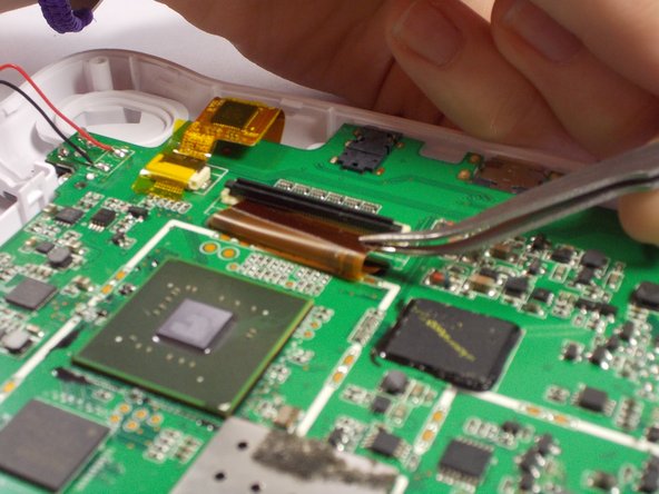

  7. Nabi Jr Screen Replacement: crwdns2935265:07crwdnd2935265:01crwdnd2935265:01crwdne2935265:0
    • Use tweezers to peel off all yellow tape from the motherboard
    • Yellow tape is used in all locations where there is ribbon cable present.
  8. Nabi Jr Screen Replacement: crwdns2935265:08crwdnd2935265:01crwdnd2935265:02crwdne2935265:0 Nabi Jr Screen Replacement: crwdns2935265:08crwdnd2935265:02crwdnd2935265:02crwdne2935265:0
    • Remove all three ribbon cables from the motherboard by lifting up the locking tabs.
    • Pull black locking tabs up in opposite direction of ribbon cable to remove.
    • Use tweezers to pull the ribbon cable out of the locking tab's slot
  9. Nabi Jr Screen Replacement: crwdns2935265:09crwdnd2935265:01crwdnd2935265:02crwdne2935265:0 Nabi Jr Screen Replacement: crwdns2935265:09crwdnd2935265:02crwdnd2935265:02crwdne2935265:0
    • Lift motherboard to separate it the from the case shell.

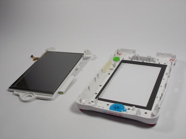

  10. Nabi Jr Screen Replacement, Screen: crwdns2935265:010crwdnd2935265:01crwdnd2935265:01crwdne2935265:0
    • Remove the 6 screws that hold the screen in place
  11. Nabi Jr Screen Replacement: crwdns2935265:011crwdnd2935265:01crwdnd2935265:02crwdne2935265:0 Nabi Jr Screen Replacement: crwdns2935265:011crwdnd2935265:02crwdnd2935265:02crwdne2935265:0
    • Remove the screen from the front casing
  12. Nabi Jr Screen Replacement: crwdns2935265:012crwdnd2935265:01crwdnd2935265:01crwdne2935265:0
    • Separate the screen from the plastic casing.
  13. Nabi Jr Screen Replacement: crwdns2935265:013crwdnd2935265:01crwdnd2935265:01crwdne2935265:0
    • Replace the old screen with the new screen
