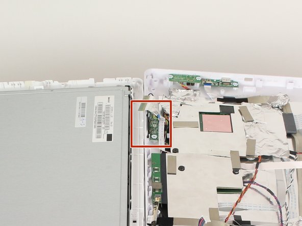

  13. Nabi Big Tab HD24 Power Button Replacement, Power Button: crwdns2935265:013crwdnd2935265:01crwdnd2935265:02crwdne2935265:0 Nabi Big Tab HD24 Power Button Replacement, Power Button: crwdns2935265:013crwdnd2935265:02crwdnd2935265:02crwdne2935265:0
    • Locate the power button assembly on the side with all the circuit boards.
    • The power button will be on the side closest to the screen when the device is opened up.
  14. Nabi Big Tab HD24 Power Button Replacement: crwdns2935265:014crwdnd2935265:01crwdnd2935265:01crwdne2935265:0
    • Lift up the black plastic tab holding the white fiber cable with the blue tip.
  15. Nabi Big Tab HD24 Power Button Replacement: crwdns2935265:015crwdnd2935265:01crwdnd2935265:01crwdne2935265:0
    • Remove the fiber cable with a blue tip by gently sliding it out.

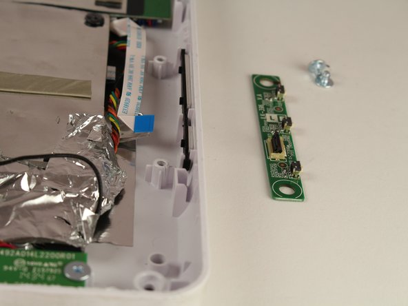

  16. Nabi Big Tab HD24 Power Button Replacement: crwdns2935265:016crwdnd2935265:01crwdnd2935265:02crwdne2935265:0 Nabi Big Tab HD24 Power Button Replacement: crwdns2935265:016crwdnd2935265:02crwdnd2935265:02crwdne2935265:0
    • Remove the 2 silver 4.5 mm screws holding the power button assembly in place using the Phillips #1 screwdriver.
    • Take out the circuit board and replace it with your new one.
    • Be sure not to remove the black padding along the edge of the tablet.
