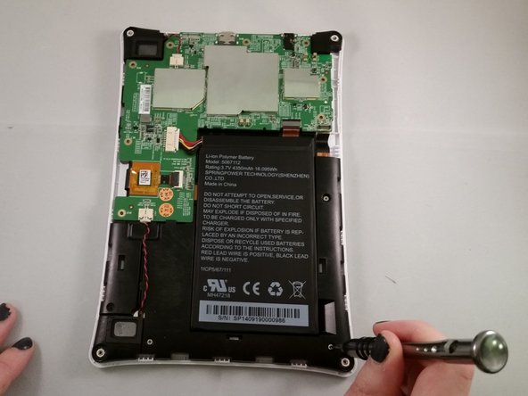

  5. Nabi 2S Screen Replacement, Screen: crwdns2935265:05crwdnd2935265:01crwdnd2935265:02crwdne2935265:0 Nabi 2S Screen Replacement, Screen: crwdns2935265:05crwdnd2935265:02crwdnd2935265:02crwdne2935265:0
    • Unscrew the circuit board from the motherboard by using a Phillips #0 screwdriver to unscrew the 4mm screws in a counter-clockwise rotation.

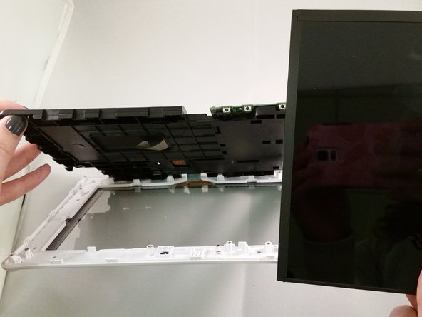

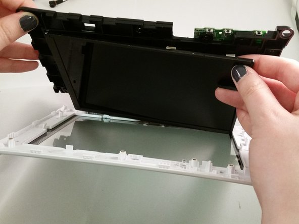

  6. Nabi 2S Screen Replacement: crwdns2935265:06crwdnd2935265:01crwdnd2935265:03crwdne2935265:0 Nabi 2S Screen Replacement: crwdns2935265:06crwdnd2935265:02crwdnd2935265:03crwdne2935265:0 Nabi 2S Screen Replacement: crwdns2935265:06crwdnd2935265:03crwdnd2935265:03crwdne2935265:0
    • Pull motherboard away from the plastic.
    • Use hands to detach the screen because it is taped to the back of the motherboard.
    • Grip the screen and slide it out from between the plastic and the circuit board.
