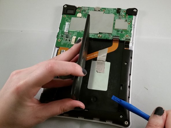

  3. Nabi 2S Battery Replacement: crwdns2935265:03crwdnd2935265:01crwdnd2935265:01crwdne2935265:0
    • Using the plastic opening tool, remove the case.
    • Removing the case will take a bit of effort and force. We recommend using two hands and if possible another person to help. It will require some gusto.
    • It is helpful to pry at the corners first to loosen the case.
  4. Nabi 2S Battery Replacement: crwdns2935265:04crwdnd2935265:01crwdnd2935265:01crwdne2935265:0
    • After the back case is loosened, remove it from the device to change or access the battery.

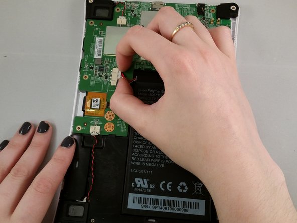

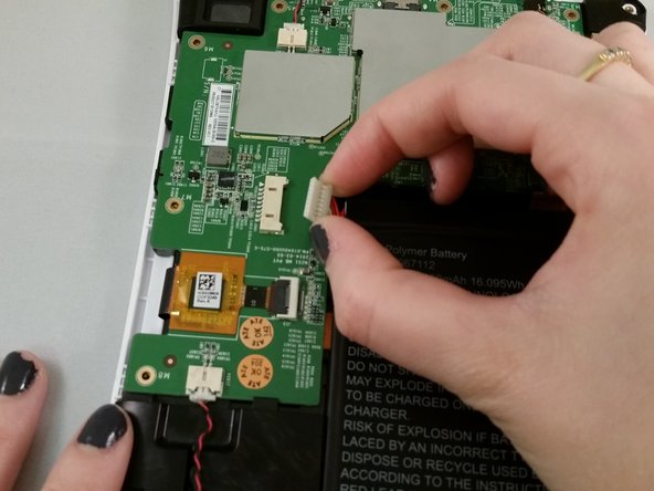

  5. Nabi 2S Battery Replacement, Battery: crwdns2935265:05crwdnd2935265:01crwdnd2935265:03crwdne2935265:0 Nabi 2S Battery Replacement, Battery: crwdns2935265:05crwdnd2935265:02crwdnd2935265:03crwdne2935265:0 Nabi 2S Battery Replacement, Battery: crwdns2935265:05crwdnd2935265:03crwdnd2935265:03crwdne2935265:0
    • Grasp the circuit connected to the battery via wires.
    • Slide the wires from the circuit to detach it.
  6. Nabi 2S Battery Replacement: crwdns2935265:06crwdnd2935265:01crwdnd2935265:02crwdne2935265:0 Nabi 2S Battery Replacement: crwdns2935265:06crwdnd2935265:02crwdnd2935265:02crwdne2935265:0
    • After the circuit is detached, the battery will be easily removable.
    • Don’t rip the battery off of the board.
    • The battery is stuck with adhesive tape to the board.
    • Use a plastic opening tool to apply pressure to the battery and lift it up from the adhesive.
