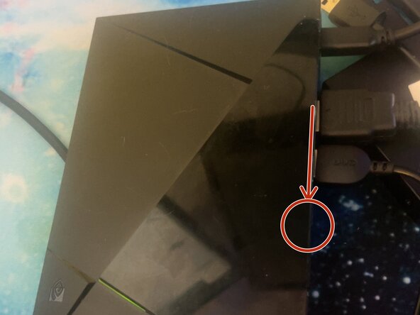

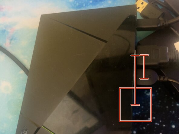

    • Use a USB 2.0 Keyboard (USB 3.0 may not work! Too much power draw!)
    • Unplug power from the Shield.
    • Plug the USB keyboard into the port closest to HDMI. Leave the next port for USB TO USB to pc.

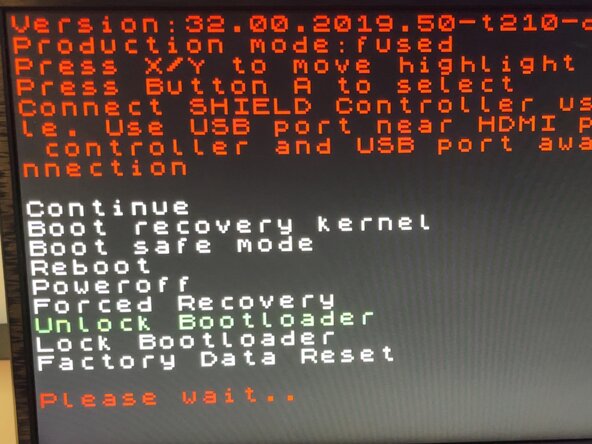

    • Hold down A + B on the keyboard.
    • While holding A + B, plug in power.
    • You should enter the NVIDIA Shield boot menu as seen in image. (If it cuts out or keeps booting, play with how quickly you release A + B, sometimes it can be sensitive)
    • If you choose "Reboot to Recovery" without being connected to a PC, you'll see a "No Command" screen and may get stuck. I was only able to do this from fastboot.

    • Connect Shield to PC via USB. (Farthest from HDMI!) It may not be showing on the computer yet, but it will soon!
    • (Note: If this does not work, I first attempted factory reset, and unlock bootloader, as well as forced recovery for these steps. These were visible in image)

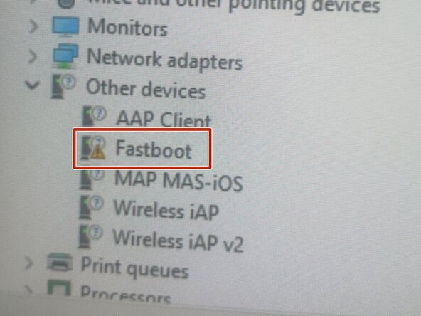

    • APX showed up for me after a failed firmware flash. I did have to retry!
    • Beforehand fastboot showed up as an unknown device. Maybe what did corrupt it, APX (NVIDIA’s USB recovery protocol) is a lower-level mode than Fastboot.
    • To install the driver:
    • Press Windows + R, type devmgmt.msc, and press Enter.
    • Look under Other devices or Universal Serial Bus Devices for something like Unknown Device, Fastboot, or APX.
    • Right-click it and choose Update driver.
    • Select Browse my computer for drivers → then Let me pick from a list of available drivers. Click Have Disk, then browse to your extracted platform-tools folder or where the Google USB Driver is located (usually inside the usb_driver folder).
    • Select android_winusb.inf and choose Android Bootloader Interface or Fastboot Interface. Click Next and allow the driver to install.

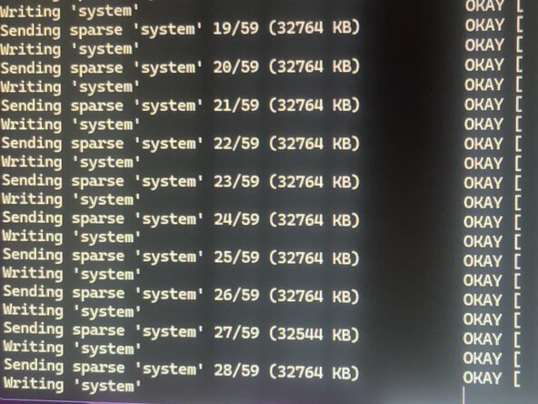

    • Run the following commands in sequence:
    • fastboot oem unlock
    • fastboot erase userdata
    • fastboot flash staging blob [Next Step->]

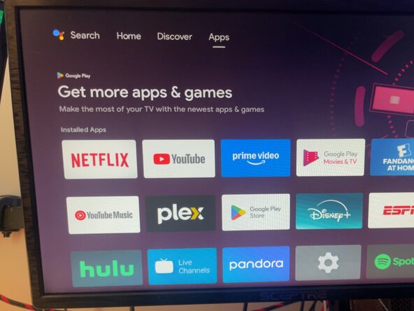

  5. NVIDIA Shield TV P2897 (2017) 16GB 4K - Firmware Reset, Final Commands!: crwdns2935265:08crwdnd2935265:01crwdnd2935265:01crwdne2935265:0
    • fastboot flash boot boot.img
    • fastboot flash system system.img
    • fastboot flash vendor vendor.img
    • fastboot flash recovery recovery.img
    • fastboot reboot

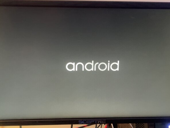

    • First boot may take a few minutes! And it may still show the original splash screen first! But give it a moment, and it should switch to Android as in the image.
  6. NVIDIA Shield TV P2897 (2017) 16GB 4K - Firmware Reset, Final Steps: crwdns2935265:09crwdnd2935265:01crwdnd2935265:01crwdne2935265:0
    • Shield boots into Android TV (Shield UI)
    • Enplug system is gone
    • Enplug splash screen may still appear briefly (cosmetic only)
    • If you're able to locate a working splash.img file from a stock Shield, please share it with the community! It may allow others to overwrite the Enplug splash if the hardware permits. Ideal sources would be a dumped bootloader.img extracted from a known clean unit. Feel free to provide partition dumps, ADB paths, or splash partition offsets.
