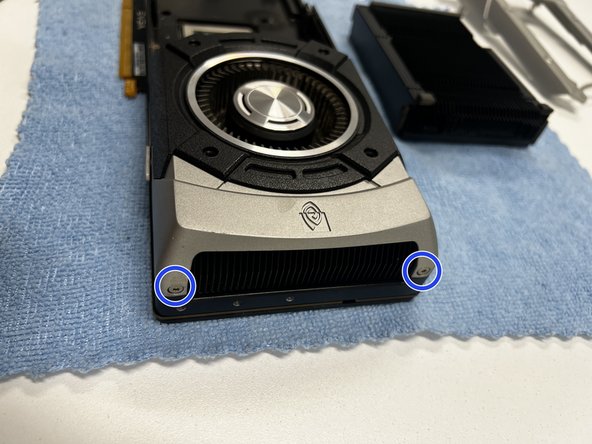

  6. NVIDIA GTX 980 Founder's Edition Teardown, Removing the fan cover: crwdns2935265:06crwdnd2935265:01crwdnd2935265:03crwdne2935265:0 NVIDIA GTX 980 Founder's Edition Teardown, Removing the fan cover: crwdns2935265:06crwdnd2935265:02crwdnd2935265:03crwdne2935265:0 NVIDIA GTX 980 Founder's Edition Teardown, Removing the fan cover: crwdns2935265:06crwdnd2935265:03crwdnd2935265:03crwdne2935265:0
    • At this stage, the first front panel and acrylic window can be removed, as well as the heatsink if you removed the four back screws.
    • To continue, remove the four circled PH0 screws circled in red.
    • Afterward, remove the two 2.5 Hex screws on the front of the card circled in blue.
    • Carefully lift the fan cover and remove the JST connector (connector with two wires coming from it) by gently wiggling it out of the socket.

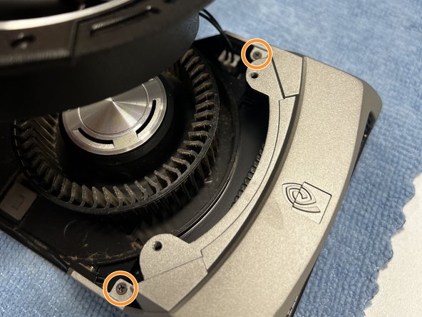

    • Lastly, remove the final two PH0 screws circled in orange.
    • Be sure to separate all of these screws when you set them aside!
