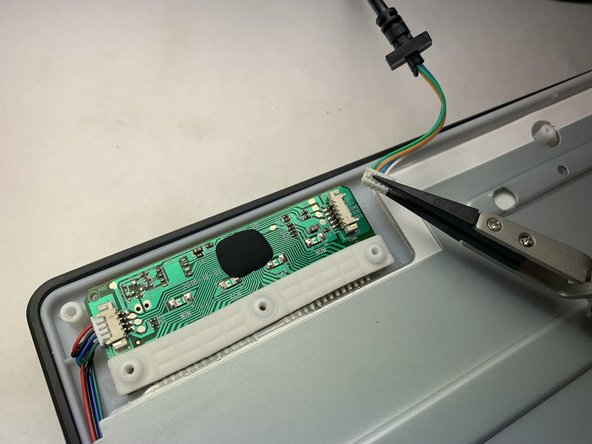

    • Flip the keyboard over so the bottom is facing upwards.
    • Remove five 4.5 mm screws using a Phillips #2 screwdriver.
    • Remove three 9 mm screws using a Phillips #2 screwdriver.
  2. NPET K10V3 USB Cable Replacement: crwdns2935265:02crwdnd2935265:01crwdnd2935265:01crwdne2935265:0
    • Remove the kickstand from the keyboard.
  3. NPET K10V3 USB Cable Replacement, USB Cable: crwdns2935265:03crwdnd2935265:01crwdnd2935265:03crwdne2935265:0 NPET K10V3 USB Cable Replacement, USB Cable: crwdns2935265:03crwdnd2935265:02crwdnd2935265:03crwdne2935265:0 NPET K10V3 USB Cable Replacement, USB Cable: crwdns2935265:03crwdnd2935265:03crwdnd2935265:03crwdne2935265:0

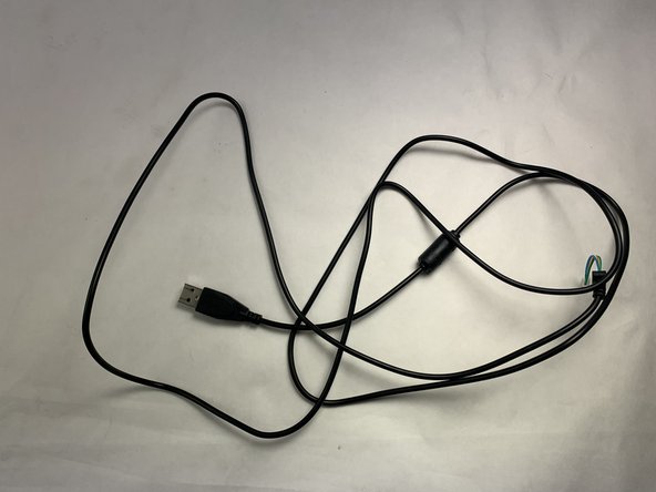

    • Remove the COM2 connection from its housing with a set of tweezers.
    • Do not pull by the wires; only pull by the plastic housing.
    • Remove the USB cable from the device.
