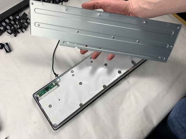

  4. NPET K10V3 Membrane Replacement: crwdns2935265:04crwdnd2935265:01crwdnd2935265:02crwdne2935265:0 NPET K10V3 Membrane Replacement: crwdns2935265:04crwdnd2935265:02crwdnd2935265:02crwdne2935265:0
    • Remove the kickstand.
    • Remove the back plate.
    • Keep in mind the location of the USB cable to ensure it is not damaged when re-assembling.

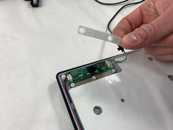

  5. NPET K10V3 Membrane Replacement: crwdns2935265:05crwdnd2935265:01crwdnd2935265:02crwdne2935265:0 NPET K10V3 Membrane Replacement: crwdns2935265:05crwdnd2935265:02crwdnd2935265:02crwdne2935265:0
    • Remove the rubber gasket that compresses the connections.
    • When removing the gasket, lift straight upward to avoid damage and snagging.
    • Clean the gasket if there is any dirt or debris.
    • Do not use chemicals or liquids when cleaning to avoid damage.

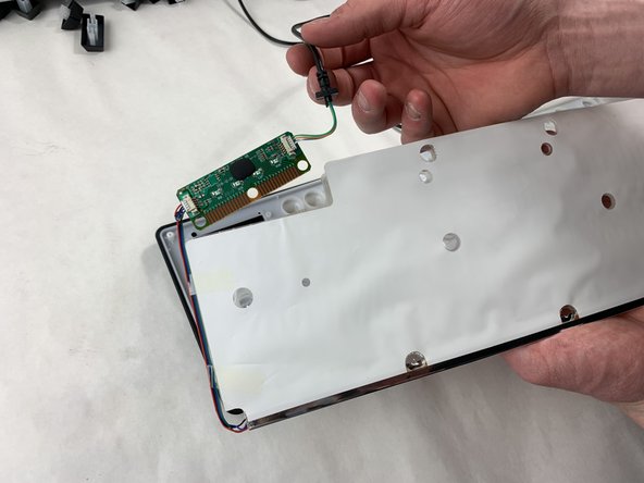

  6. NPET K10V3 Membrane Replacement: crwdns2935265:06crwdnd2935265:01crwdnd2935265:02crwdne2935265:0 NPET K10V3 Membrane Replacement: crwdns2935265:06crwdnd2935265:02crwdnd2935265:02crwdne2935265:0
    • Remove the membrane gently to reveal the copper connections for both motherboard and membrane.
    • Remove the motherboard from the membrane.
    • Remove the membrane out with the motherboard.
    • When removing both parts, lift straight upward to avoid damage and snagging.
