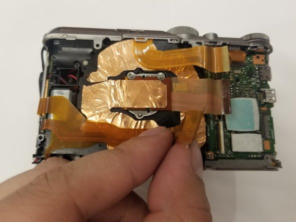

    • Use your finger to undo the three ribbon connectors.
    • Make sure that all ribbons are properly disconnected before proceeding.
  15. NIkon Coolpix A900 Lens Replacement: crwdns2935265:015crwdnd2935265:01crwdnd2935265:03crwdne2935265:0 NIkon Coolpix A900 Lens Replacement: crwdns2935265:015crwdnd2935265:02crwdnd2935265:03crwdne2935265:0 NIkon Coolpix A900 Lens Replacement: crwdns2935265:015crwdnd2935265:03crwdnd2935265:03crwdne2935265:0

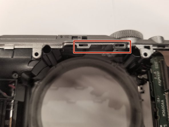

    • Carefully lift the lens out of the camera.
    • It may be necessary to gently pry these tabs out of the way to release the lens.
    • When reassembling, make sure that the ribbon cables are flat against the lens to ensure that they don't snag.
  16. NIkon Coolpix A900 Lens Replacement: crwdns2935265:016crwdnd2935265:01crwdnd2935265:01crwdne2935265:0
    • Separate the lens from the body of the camera.
