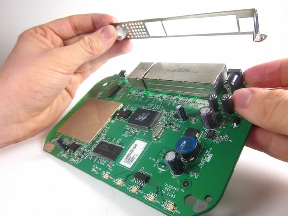

  13. NETGEAR WGT624 v3 Reset Button Replacement, Reset Button: crwdns2935265:013crwdnd2935265:01crwdnd2935265:02crwdne2935265:0 NETGEAR WGT624 v3 Reset Button Replacement, Reset Button: crwdns2935265:013crwdnd2935265:02crwdnd2935265:02crwdne2935265:0
    • Remove the metal frame.
