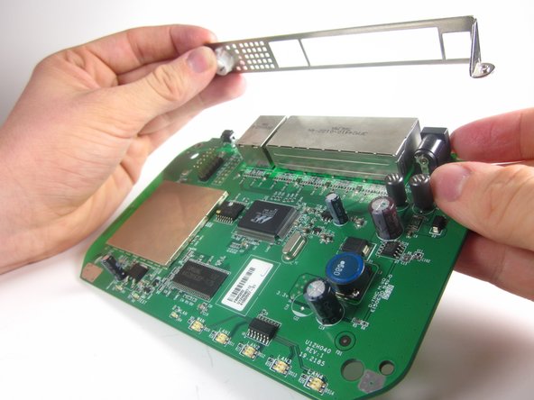

  13. NETGEAR WGT624 v3 Power Supply Replacement, Power Supply: crwdns2935265:013crwdnd2935265:01crwdnd2935265:01crwdne2935265:0
    • Unscrew the two 5 mm Phillips Head screws located at the front corners of the motherboard.
  14. NETGEAR WGT624 v3 Power Supply Replacement: crwdns2935265:014crwdnd2935265:01crwdnd2935265:02crwdne2935265:0 NETGEAR WGT624 v3 Power Supply Replacement: crwdns2935265:014crwdnd2935265:02crwdnd2935265:02crwdne2935265:0
    • Take off the metal frame.

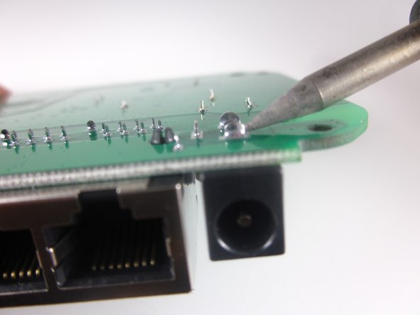

  15. NETGEAR WGT624 v3 Power Supply Replacement: crwdns2935265:015crwdnd2935265:01crwdnd2935265:01crwdne2935265:0
    • Turn over the motherboard, so that the bottom is facing up.
  16. NETGEAR WGT624 v3 Power Supply Replacement: crwdns2935265:016crwdnd2935265:01crwdnd2935265:02crwdne2935265:0 NETGEAR WGT624 v3 Power Supply Replacement: crwdns2935265:016crwdnd2935265:02crwdnd2935265:02crwdne2935265:0
    • Do not refer to the pictures in this step for correct soldering and de-soldering techniques. They are solely for illustration purposes.
    • Desolder the three connections between the reset button and the motherboard
    • For proper soldering and desoldering techniques, refer here.
    • Pull the power source from the other side of the mother board once the solder is liquid.
