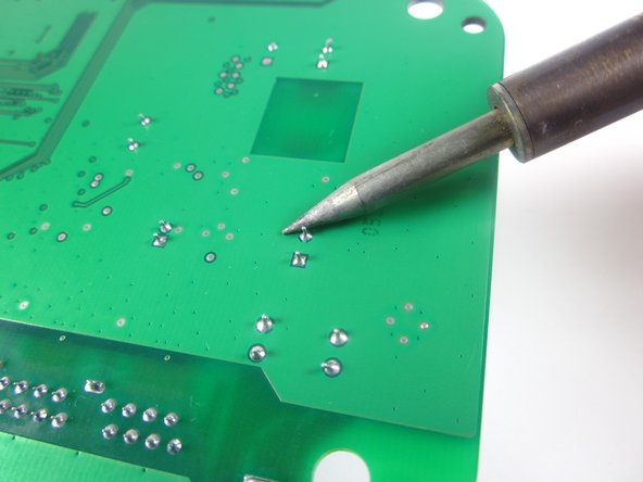

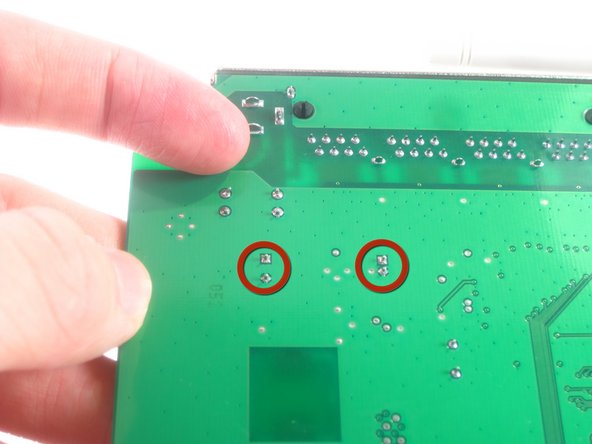

      • Turn the motherboard so that the bottom is facing upwards.
      • Locate the two soldered contacts for each capacitor.
    4. NETGEAR WGT624 v3 Capacitor Replacement: crwdns2935265:010crwdnd2935265:01crwdnd2935265:02crwdne2935265:0 NETGEAR WGT624 v3 Capacitor Replacement: crwdns2935265:010crwdnd2935265:02crwdnd2935265:02crwdne2935265:0
      • Do not refer to the pictures in this step for correct soldering and de-soldering techniques. They are solely for illustration purposes.
      • Desolder the soldered connections between the capacitors and the motherboard, and pull the capacitor from the motherboard.
      • For proper soldering and de-soldering techniques, refer here.
      • When reinstalling the capacitor, make sure the negative side of the capacitor is aligned with the shaded white region of the circle.
