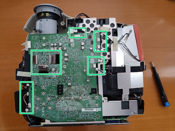

  3. NEC VT570 Dismantling, Removing motherboard: crwdns2935265:03crwdnd2935265:01crwdnd2935265:03crwdne2935265:0 NEC VT570 Dismantling, Removing motherboard: crwdns2935265:03crwdnd2935265:02crwdnd2935265:03crwdne2935265:0 NEC VT570 Dismantling, Removing motherboard: crwdns2935265:03crwdnd2935265:03crwdnd2935265:03crwdne2935265:0
    • Unscrew four screws.
    • Detached plugged cables marked with green squares.
    • Remove motherboard.

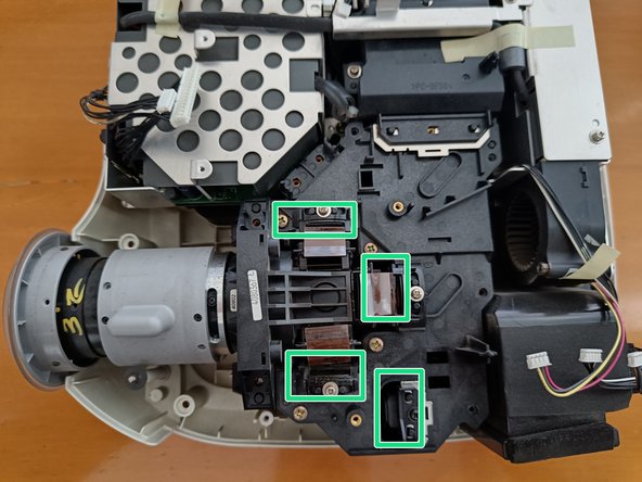

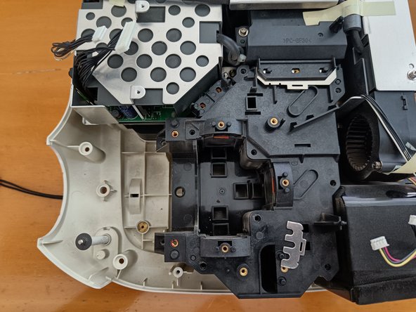

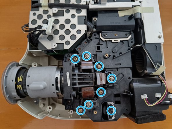

  5. NEC VT570 Dismantling, Removing mirrors and filters: crwdns2935265:05crwdnd2935265:01crwdnd2935265:03crwdne2935265:0 NEC VT570 Dismantling, Removing mirrors and filters: crwdns2935265:05crwdnd2935265:02crwdnd2935265:03crwdne2935265:0 NEC VT570 Dismantling, Removing mirrors and filters: crwdns2935265:05crwdnd2935265:03crwdnd2935265:03crwdne2935265:0
    • Remove screws Green are screws that are not seen in the picture.
    • After removing the top cover there are more screws
    • Remove four lances

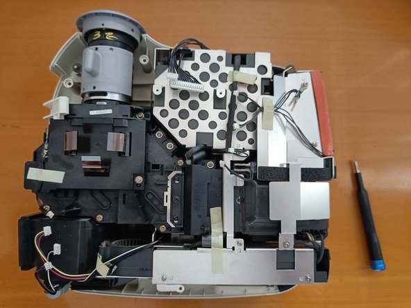

  6. NEC VT570 Dismantling, Removing main lans: crwdns2935265:06crwdnd2935265:01crwdnd2935265:02crwdne2935265:0 NEC VT570 Dismantling, Removing main lans: crwdns2935265:06crwdnd2935265:02crwdnd2935265:02crwdne2935265:0
    • After 5th step, you can just pull out the main lens.

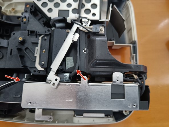

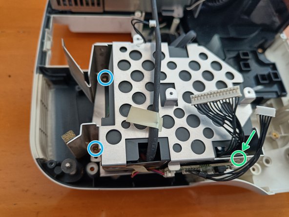

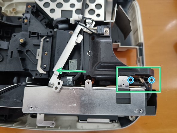

  7. NEC VT570 Dismantling, Removing electricity part 1/2: crwdns2935265:07crwdnd2935265:01crwdnd2935265:03crwdne2935265:0 NEC VT570 Dismantling, Removing electricity part 1/2: crwdns2935265:07crwdnd2935265:02crwdnd2935265:03crwdne2935265:0 NEC VT570 Dismantling, Removing electricity part 1/2: crwdns2935265:07crwdnd2935265:03crwdnd2935265:03crwdne2935265:0
    • Unsrew screws (blue), green screw is a bit hidden.
    • Remove upper backplate.
    • Unscrew the connector and pull it out.
    • To pull the electricity part we should remove other parts first since they stick to cables connected to other modules.

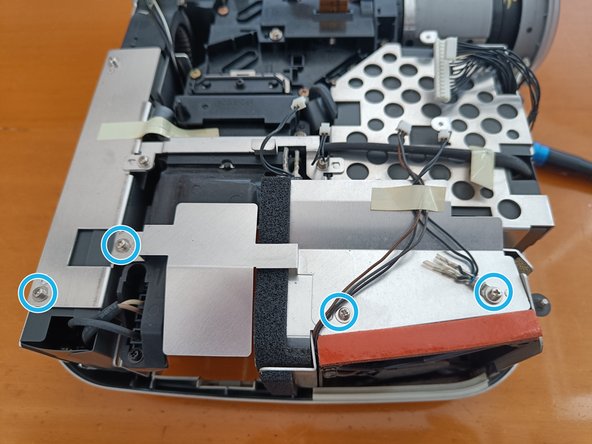

  8. NEC VT570 Dismantling, Removing lence housing: crwdns2935265:08crwdnd2935265:01crwdnd2935265:03crwdne2935265:0 NEC VT570 Dismantling, Removing lence housing: crwdns2935265:08crwdnd2935265:02crwdnd2935265:03crwdne2935265:0 NEC VT570 Dismantling, Removing lence housing: crwdns2935265:08crwdnd2935265:03crwdnd2935265:03crwdne2935265:0
    • Remove screws.
    • Take out the lens housing. Inside the lens housing are several small mirrors so be careful they don't fall out and brake.

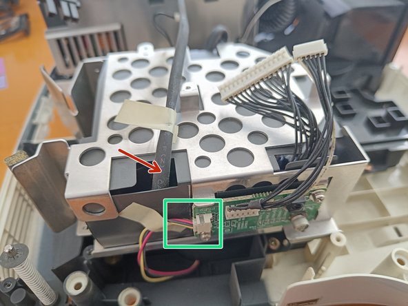

  9. NEC VT570 Dismantling, Removing electricity part 2/2: crwdns2935265:09crwdnd2935265:01crwdnd2935265:03crwdne2935265:0 NEC VT570 Dismantling, Removing electricity part 2/2: crwdns2935265:09crwdnd2935265:02crwdnd2935265:03crwdne2935265:0 NEC VT570 Dismantling, Removing electricity part 2/2: crwdns2935265:09crwdnd2935265:03crwdnd2935265:03crwdne2935265:0
    • Remove screws.
    • Green marked screw is a bit hidden inside the case.
    • Unplug the side cable and you can take out the module.
    • Once the module is partly outside you can open the iron frame and unplug the other two black cables plugs into this module from each side.

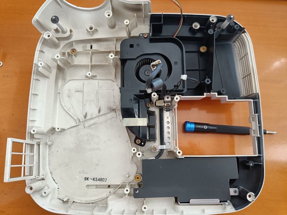

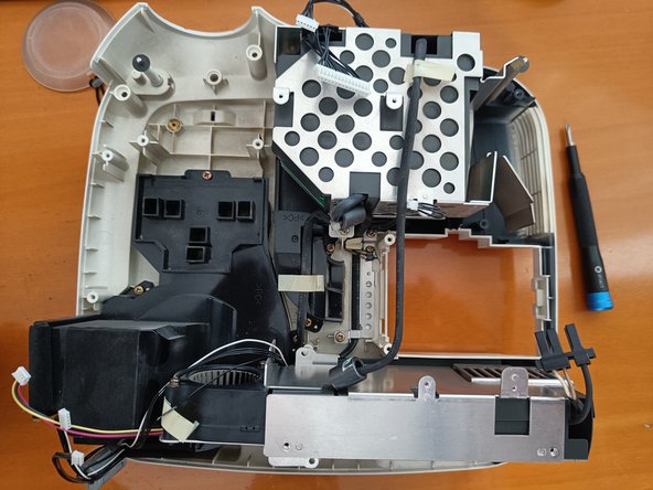

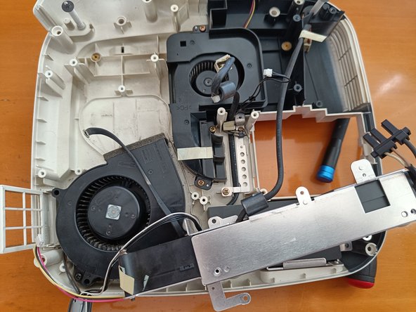

  10. NEC VT570 Dismantling, Removing filter and fan module: crwdns2935265:010crwdnd2935265:01crwdnd2935265:03crwdne2935265:0 NEC VT570 Dismantling, Removing filter and fan module: crwdns2935265:010crwdnd2935265:02crwdnd2935265:03crwdne2935265:0 NEC VT570 Dismantling, Removing filter and fan module: crwdns2935265:010crwdnd2935265:03crwdnd2935265:03crwdne2935265:0
    • Remove marked screws. Green is not seen in the picture but it is there.
    • Remove the plastic cover and you'll find a big fan under it.
    • Now you can pull out the big fan together with the electrical module 1.

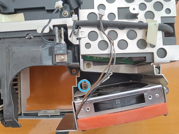

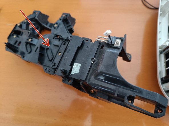

  11. NEC VT570 Dismantling, Removing last fan: crwdns2935265:011crwdnd2935265:01crwdnd2935265:01crwdne2935265:0
    • Remove the screws and we can pull down the fan cover and fan.
