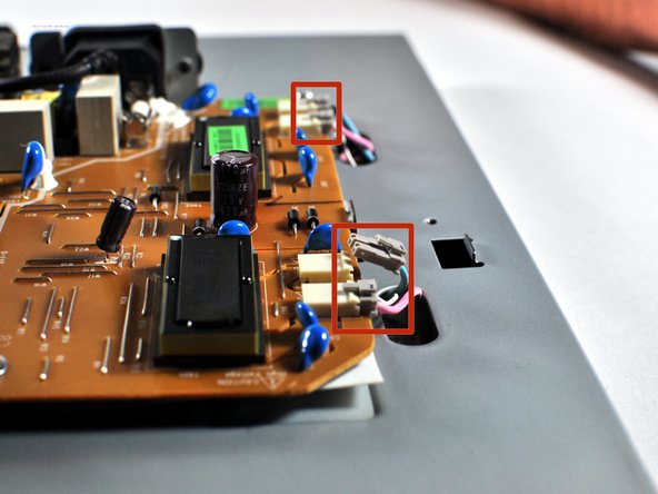

    1. NEC LCD1770NX Screen Replacement, Screen: crwdns2935265:014crwdnd2935265:01crwdnd2935265:02crwdne2935265:0 NEC LCD1770NX Screen Replacement, Screen: crwdns2935265:014crwdnd2935265:02crwdnd2935265:02crwdne2935265:0
      • Unplug the pink and light blue attachments from the side of the brown board by pulling up on the tabs and gently pulling the cord out.
      • Label where the plugs go.

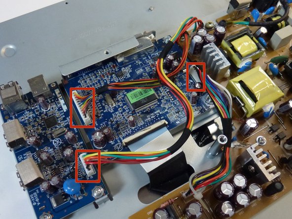

    2. NEC LCD1770NX Screen Replacement: crwdns2935265:015crwdnd2935265:01crwdnd2935265:02crwdne2935265:0 NEC LCD1770NX Screen Replacement: crwdns2935265:015crwdnd2935265:02crwdnd2935265:02crwdne2935265:0
      • Unplug the 3 multicolored cables from the blue board by gently wiggling them back and forth while pulling up.

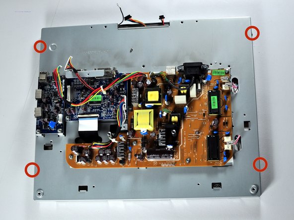

    3. NEC LCD1770NX Screen Replacement: crwdns2935265:016crwdnd2935265:01crwdnd2935265:02crwdne2935265:0 NEC LCD1770NX Screen Replacement: crwdns2935265:016crwdnd2935265:02crwdnd2935265:02crwdne2935265:0
      • Unscrew the 4 5mm Phillips PH2 screws on the sides of the monitor.

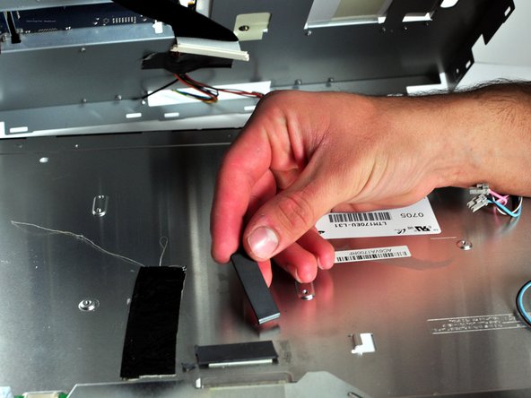

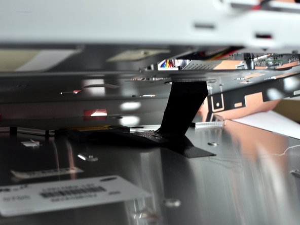

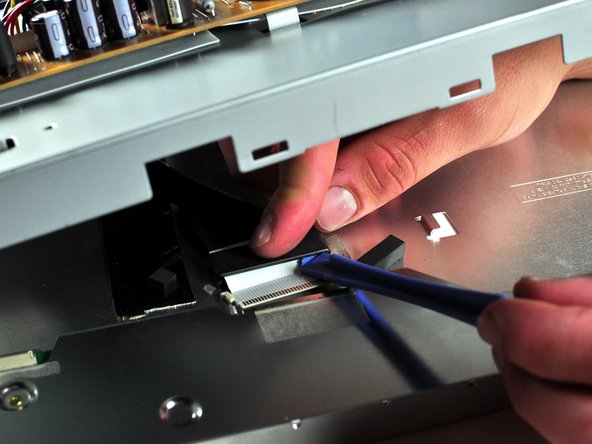

    4. NEC LCD1770NX Screen Replacement: crwdns2935265:017crwdnd2935265:01crwdnd2935265:03crwdne2935265:0 NEC LCD1770NX Screen Replacement: crwdns2935265:017crwdnd2935265:02crwdnd2935265:03crwdne2935265:0 NEC LCD1770NX Screen Replacement: crwdns2935265:017crwdnd2935265:03crwdnd2935265:03crwdne2935265:0
      • Begin opening the enclosure by slowing pulling up on back panel of the monitor.
      • The enclosure should still be attached by a cable; this cable is held down by tape. Remove this tape.

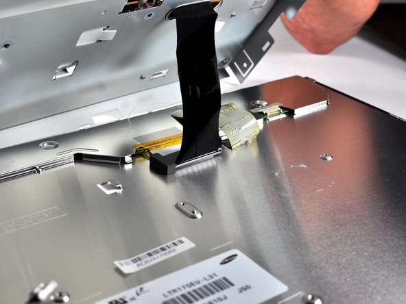

    5. NEC LCD1770NX Screen Replacement: crwdns2935265:018crwdnd2935265:01crwdnd2935265:03crwdne2935265:0 NEC LCD1770NX Screen Replacement: crwdns2935265:018crwdnd2935265:02crwdnd2935265:03crwdne2935265:0 NEC LCD1770NX Screen Replacement: crwdns2935265:018crwdnd2935265:03crwdnd2935265:03crwdne2935265:0
      • Unplug the cable from the screen. It is still attached by a fragile black belt.
      • Use a spudger to break the black ceramic belt to free the screen from the rest, allowing it to be replaced.
