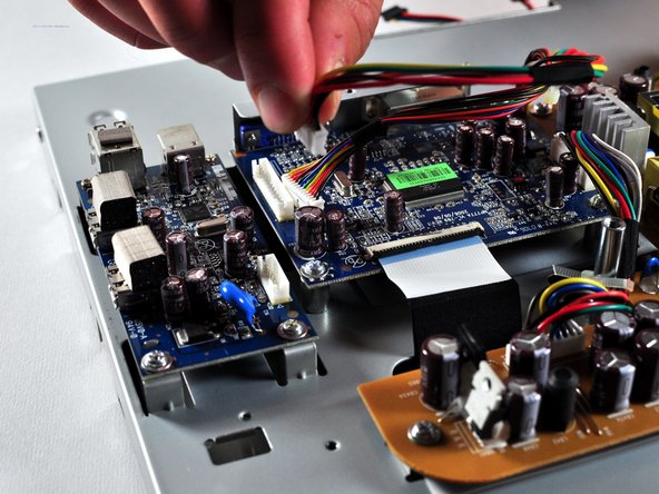

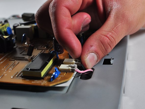

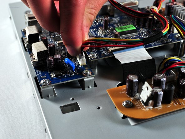

    1. NEC LCD1770NX Power Input Replacement, Power Circuit Board: crwdns2935265:014crwdnd2935265:01crwdnd2935265:03crwdne2935265:0 NEC LCD1770NX Power Input Replacement, Power Circuit Board: crwdns2935265:014crwdnd2935265:02crwdnd2935265:03crwdne2935265:0 NEC LCD1770NX Power Input Replacement, Power Circuit Board: crwdns2935265:014crwdnd2935265:03crwdnd2935265:03crwdne2935265:0
      • Make a note or use a pen to mark which plugs correspond to which colors. (Pink or Blue)
      • Remove the four plugs on the brown circuit board by pulling up on the tabs and wiggling them out. You could also use a spudger to help you lift little clips holding them in.

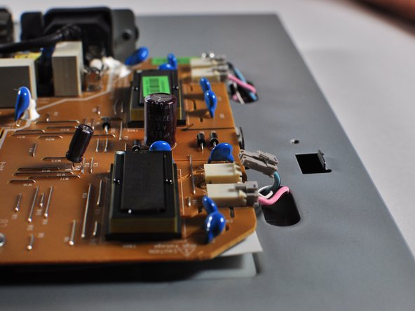

    2. NEC LCD1770NX Power Input Replacement: crwdns2935265:015crwdnd2935265:01crwdnd2935265:03crwdne2935265:0 NEC LCD1770NX Power Input Replacement: crwdns2935265:015crwdnd2935265:02crwdnd2935265:03crwdne2935265:0 NEC LCD1770NX Power Input Replacement: crwdns2935265:015crwdnd2935265:03crwdnd2935265:03crwdne2935265:0
      • Locate the several multi-wire connectors on the board.
      • These connect several parts of each board together and consist of several different colors of wires. There is also a zip-tie holding the two sets of wires together that you can cut if it is getting in your way.
      • Disconnect the three plastic connectors from the blue colored boards by pulling them up while wiggling them.
      • Some force is necessary, it may also help to use the Large Needle Nose Pliers.

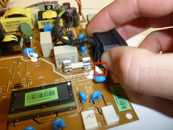

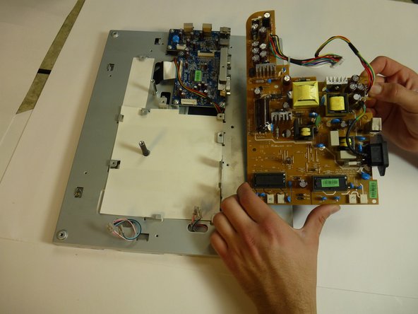

      • Locate the large black power plug.
      • Using a Phillips #1 Screwdriver, unscrew the two 8mm colts holding the black tabs to the metal frame.
    4. NEC LCD1770NX Power Input Replacement: crwdns2935265:017crwdnd2935265:01crwdnd2935265:01crwdne2935265:0
      • Locate and remove the gold colored 10mm Philips screw located near the black power plug. It holds in a wire that connects to the power plug.

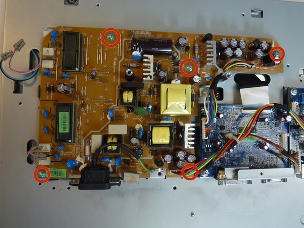

    5. NEC LCD1770NX Power Input Replacement: crwdns2935265:018crwdnd2935265:01crwdnd2935265:02crwdne2935265:0 NEC LCD1770NX Power Input Replacement: crwdns2935265:018crwdnd2935265:02crwdnd2935265:02crwdne2935265:0
      • Remove 5 8mm Phillip1 screws, with a Philips 1 screwdriver, located in various places on the board.
    6. NEC LCD1770NX Power Input Replacement: crwdns2935265:019crwdnd2935265:01crwdnd2935265:02crwdne2935265:0 NEC LCD1770NX Power Input Replacement: crwdns2935265:019crwdnd2935265:02crwdnd2935265:02crwdne2935265:0
      • Lift the brown power supply board off of the frame and set it aside.

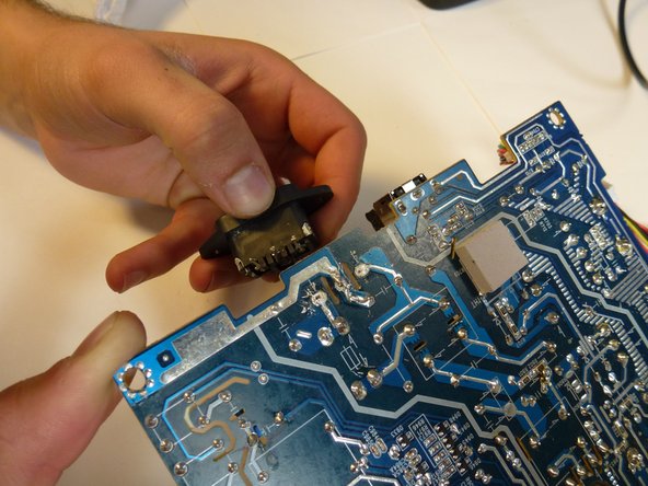

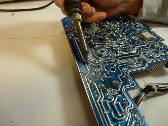

    1. NEC LCD1770NX Power Input Replacement, Power Input: crwdns2935265:020crwdnd2935265:01crwdnd2935265:02crwdne2935265:0 NEC LCD1770NX Power Input Replacement, Power Input: crwdns2935265:020crwdnd2935265:02crwdnd2935265:02crwdne2935265:0
      • Remove the solder from the three joints attached to the power input.
    2. NEC LCD1770NX Power Input Replacement: crwdns2935265:021crwdnd2935265:01crwdnd2935265:03crwdne2935265:0 NEC LCD1770NX Power Input Replacement: crwdns2935265:021crwdnd2935265:02crwdnd2935265:03crwdne2935265:0 NEC LCD1770NX Power Input Replacement: crwdns2935265:021crwdnd2935265:03crwdnd2935265:03crwdne2935265:0
      • Grab hold of the power supply jack and remove it from the power supply board.
      • A little force and a wiggling action may be needed to remove the power supply jack from the glue.
