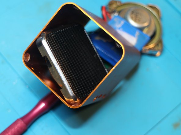

  2. MusicAngel JH-MD04E2 wired speakers Disassembly, Opening the speaker: crwdns2935265:02crwdnd2935265:01crwdnd2935265:03crwdne2935265:0 MusicAngel JH-MD04E2 wired speakers Disassembly, Opening the speaker: crwdns2935265:02crwdnd2935265:02crwdnd2935265:03crwdne2935265:0 MusicAngel JH-MD04E2 wired speakers Disassembly, Opening the speaker: crwdns2935265:02crwdnd2935265:03crwdnd2935265:03crwdne2935265:0
    • Use a very thin metal prying tool and slide it in between the metal looking grill and the speaker body. Carefully pry it out (no glue is used) all the way around.
    • Repeat on both speaker sides.

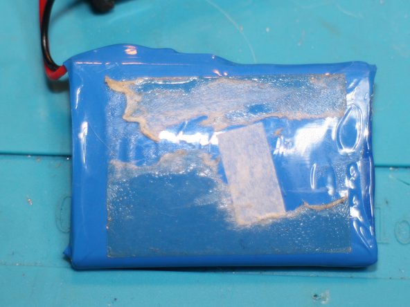

  3. MusicAngel JH-MD04E2 wired speakers Disassembly, Taking out the parts: crwdns2935265:03crwdnd2935265:01crwdnd2935265:03crwdne2935265:0 MusicAngel JH-MD04E2 wired speakers Disassembly, Taking out the parts: crwdns2935265:03crwdnd2935265:02crwdnd2935265:03crwdne2935265:0 MusicAngel JH-MD04E2 wired speakers Disassembly, Taking out the parts: crwdns2935265:03crwdnd2935265:03crwdnd2935265:03crwdne2935265:0
    • Use a spudger to pry the battery that is glued to the top, from the body. Note: This is pretty strong adhesive.
    • Tilt the speaker grill / element a little, to slide it through the body.

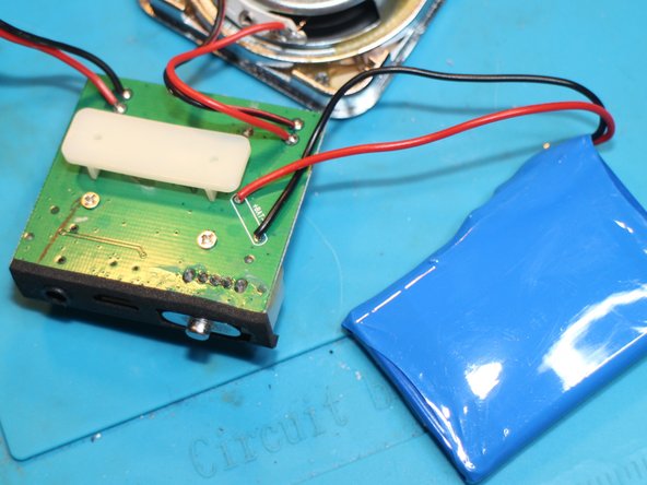

  4. MusicAngel JH-MD04E2 wired speakers Disassembly, Information: crwdns2935265:04crwdnd2935265:01crwdnd2935265:03crwdne2935265:0 MusicAngel JH-MD04E2 wired speakers Disassembly, Information: crwdns2935265:04crwdnd2935265:02crwdnd2935265:03crwdne2935265:0 MusicAngel JH-MD04E2 wired speakers Disassembly, Information: crwdns2935265:04crwdnd2935265:03crwdnd2935265:03crwdne2935265:0
    • As you can see, there are no connectors used. All connections are soldered directly to the board.
    • No information can be found on the battery, either side.

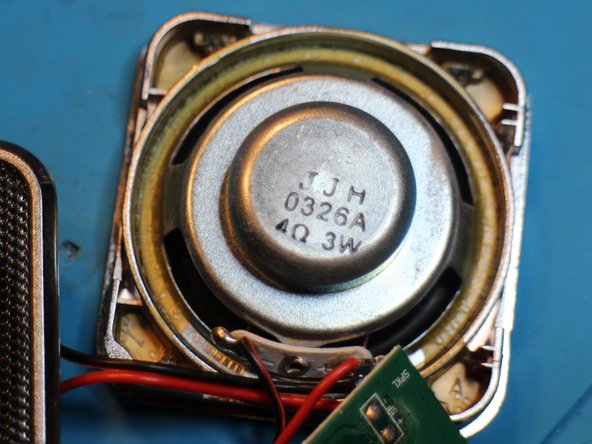

    • The speaker elements are 45mm, 3W and 4Ω
  5. MusicAngel JH-MD04E2 wired speakers Disassembly, Board overview: crwdns2935265:05crwdnd2935265:01crwdnd2935265:01crwdne2935265:0
    • Not really much going on on this board.
