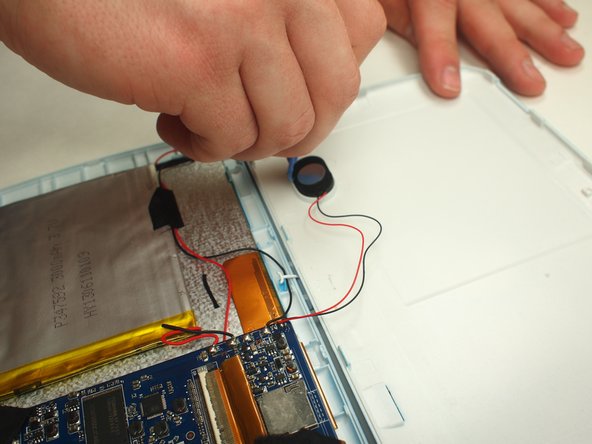

    1. Munchkinz Speaker Replacement, Pry Speaker: crwdns2935265:04crwdnd2935265:01crwdnd2935265:02crwdne2935265:0 Munchkinz Speaker Replacement, Pry Speaker: crwdns2935265:04crwdnd2935265:02crwdnd2935265:02crwdne2935265:0
      • Use the slim plastic opening tool to remove the speaker from its position on the case.
    2. Munchkinz Speaker Replacement, Locate Wires: crwdns2935265:05crwdnd2935265:01crwdnd2935265:01crwdne2935265:0
      • Locate the red and black wires that connect the speaker to the motherboard.
    3. Munchkinz Speaker Replacement, Solder Wires: crwdns2935265:06crwdnd2935265:01crwdnd2935265:01crwdne2935265:0
      • Un-solder the red and black speaker wires that are connected to the motherboard
