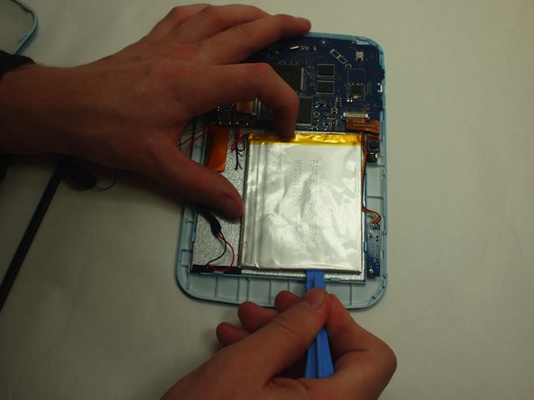

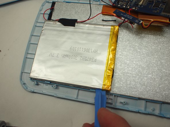

    1. Munchkinz Motherboard Replacement, Removing battery: crwdns2935265:012crwdnd2935265:01crwdnd2935265:03crwdne2935265:0 Munchkinz Motherboard Replacement, Removing battery: crwdns2935265:012crwdnd2935265:02crwdnd2935265:03crwdne2935265:0 Munchkinz Motherboard Replacement, Removing battery: crwdns2935265:012crwdnd2935265:03crwdnd2935265:03crwdne2935265:0
      • Use the wide plastic opening tool to slowly pry each side of the battery up.
      • Be careful not to bend the battery too much.
    2. Munchkinz Motherboard Replacement, Remove battery completely: crwdns2935265:013crwdnd2935265:01crwdnd2935265:01crwdne2935265:0
      • Use the Soldering Iron to disconnect the each cable.
