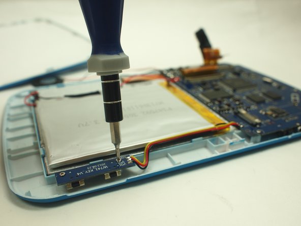

    3. Munchkinz LCD Assembly, Unscrew Volume Module: crwdns2935265:06crwdnd2935265:01crwdnd2935265:02crwdne2935265:0 Munchkinz LCD Assembly, Unscrew Volume Module: crwdns2935265:06crwdnd2935265:02crwdnd2935265:02crwdne2935265:0
      • Unscrew the two screws that hold the volume module to the casing.

    6. Munchkinz LCD Assembly, Remove Screws: crwdns2935265:09crwdnd2935265:01crwdnd2935265:01crwdne2935265:0
      • Use the screw driver to remove the highlighted screws.
    7. Munchkinz LCD Assembly, Remove Hidden Screw: crwdns2935265:010crwdnd2935265:01crwdnd2935265:01crwdne2935265:0
      • Use the plastic opening tool to hold the camera ribbon back.
      • Unscrew the screw under ribbon with the screw driver.

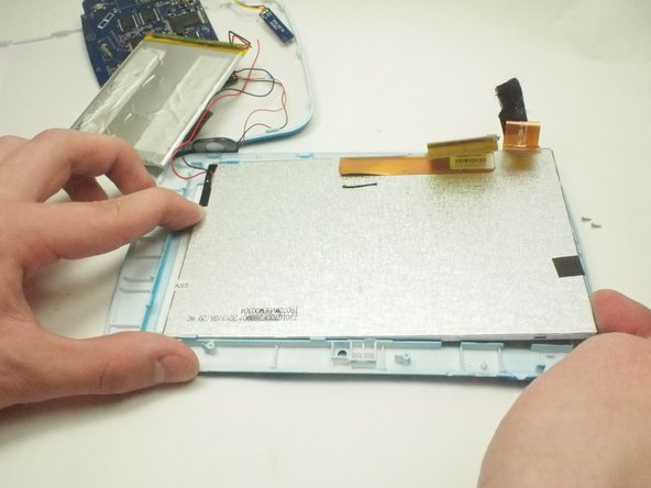

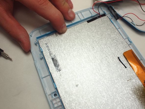

    9. Munchkinz LCD Assembly, Pry Up Screen: crwdns2935265:012crwdnd2935265:01crwdnd2935265:03crwdne2935265:0 Munchkinz LCD Assembly, Pry Up Screen: crwdns2935265:012crwdnd2935265:02crwdnd2935265:03crwdne2935265:0 Munchkinz LCD Assembly, Pry Up Screen: crwdns2935265:012crwdnd2935265:03crwdnd2935265:03crwdne2935265:0
      • Oriented the device so the battery is closest to the user.
      • Use the plastic opening tool to pry the clips up to release LCD screen.
      • Gently lift the northern end of the screen and slide it out horizontally.
    10. Munchkinz LCD Assembly, Solder LCD Wires: crwdns2935265:013crwdnd2935265:01crwdnd2935265:01crwdne2935265:0
      • Unsolder the black and red LCD wires.
