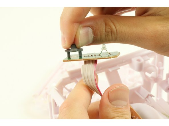

  8. Munchkin Mozart Magic Cube Sound Button Replacement, Sound Button: crwdns2935265:08crwdnd2935265:01crwdnd2935265:01crwdne2935265:0
    • Flip the frame over so that green motherboard over so that the LED is face down and the brown side of the motherboard is face up using the Jimmy to remove the glue connecting the motherboard to the white frame.
  9. Munchkin Mozart Magic Cube Sound Button Replacement: crwdns2935265:09crwdnd2935265:01crwdnd2935265:01crwdne2935265:0
    • Slide the motherboard out of the frame.
  10. Munchkin Mozart Magic Cube Sound Button Replacement: crwdns2935265:010crwdnd2935265:01crwdnd2935265:02crwdne2935265:0 Munchkin Mozart Magic Cube Sound Button Replacement: crwdns2935265:010crwdnd2935265:02crwdnd2935265:02crwdne2935265:0
    • To remove the button use your fingers or forceps to remove the gray rubber button piece on the green side of the motherboard.
