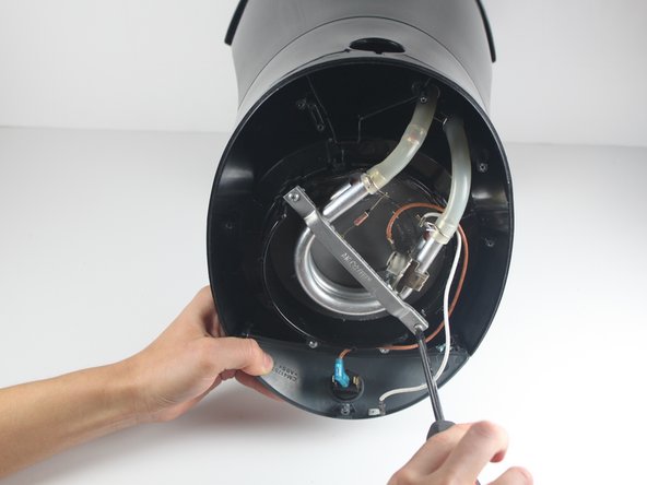

    • Identify and remove the two 13mm screws securing the silver support bracket using a phillips head screw driver.
  5. Mr. Coffee DW13 Tubing Replacement: crwdns2935265:05crwdnd2935265:01crwdnd2935265:01crwdne2935265:0
    • Gently lift the silver support bracket freeing the heating plate from the heating coil.

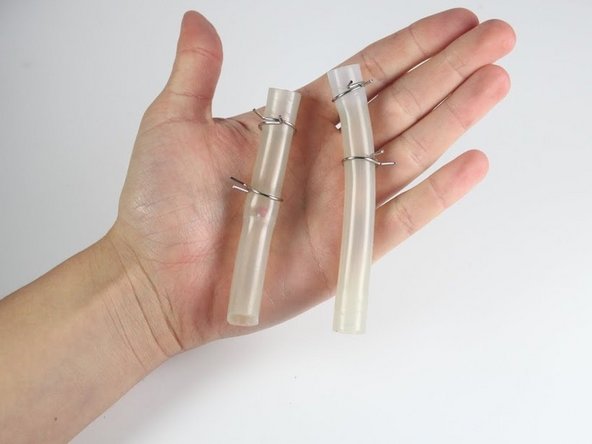

    • Use pliers to pinch and loosen the crimps.
  7. Mr. Coffee DW13 Tubing Replacement: crwdns2935265:07crwdnd2935265:01crwdnd2935265:01crwdne2935265:0
    • Once the crimps are loosened, slide them down the tubing.
  8. Mr. Coffee DW13 Tubing Replacement: crwdns2935265:08crwdnd2935265:01crwdnd2935265:02crwdne2935265:0 Mr. Coffee DW13 Tubing Replacement: crwdns2935265:08crwdnd2935265:02crwdnd2935265:02crwdne2935265:0
    • Separate the tubing from the heating coil by grasping the tubing in one hand and the heating coil in the other and gently pulling apart.
  9. Mr. Coffee DW13 Tubing Replacement: crwdns2935265:09crwdnd2935265:01crwdnd2935265:03crwdne2935265:0 Mr. Coffee DW13 Tubing Replacement: crwdns2935265:09crwdnd2935265:02crwdnd2935265:03crwdne2935265:0 Mr. Coffee DW13 Tubing Replacement: crwdns2935265:09crwdnd2935265:03crwdnd2935265:03crwdne2935265:0
    • Gently pull on plastic tubing, freeing it from the coffee maker
    • One of the tubes has a red ball check valve in the middle. Be sure to note which hole it connects to.

Great photos. I've done this on another mr coffee model twice. Once for lime buildup, once for a coffee ground clogging it. Make sure you are gentle with the soft tubing. I split the hose at one end. The clamps now barely covers the split, but I'm looking for a replacement tube and ball valve.
markvassmer - crwdns2934203:0crwdne2934203:0
I did not have to detach the heating coil from the plate in order to remove the tubing.
I found that the check valve was clogged with debris on my unit. Blowing it out cleared the clog. My unit's check valve is built into the tube that goes from the reservoir to the coil, so I only had to remove that tube to solve my issue.
rulegit2000 - crwdns2934203:0crwdne2934203:0
Where does the tube with the check valve attach?
latimert36@windstream.net
Thomas Latimer -
Water inlet tube from the tank on my model Mr. Coffee BVMC-SJX33GT.
