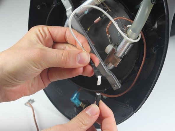

    • Locate the 2 electrical connectors running from the black plastic-coated power cord to the interior of the power switch.
    • One cord is copper colored and ends at the power switch in a silver metal square.
    • The other cord is white and ends at the power switch in a black plastic square.
  7. Mr. Coffee DW13 Power Cord Replacement: crwdns2935265:07crwdnd2935265:01crwdnd2935265:02crwdne2935265:0 Mr. Coffee DW13 Power Cord Replacement: crwdns2935265:07crwdnd2935265:02crwdnd2935265:02crwdne2935265:0
    • Grasp the copper cord close to the power switch. Lightly pull the silver end tab from the end to detach it.
  8. Mr. Coffee DW13 Power Cord Replacement: crwdns2935265:08crwdnd2935265:01crwdnd2935265:02crwdne2935265:0 Mr. Coffee DW13 Power Cord Replacement: crwdns2935265:08crwdnd2935265:02crwdnd2935265:02crwdne2935265:0
    • Lightly pull the white cord away from the power switch by grasping the black plastic-coated head.
    • There are two white cords attached to each other. Pull them apart by grasping the different black heads and separating them.
  9. Mr. Coffee DW13 Power Cord Replacement: crwdns2935265:09crwdnd2935265:01crwdnd2935265:03crwdne2935265:0 Mr. Coffee DW13 Power Cord Replacement: crwdns2935265:09crwdnd2935265:02crwdnd2935265:03crwdne2935265:0 Mr. Coffee DW13 Power Cord Replacement: crwdns2935265:09crwdnd2935265:03crwdnd2935265:03crwdne2935265:0
    • Pull the power cord through the hole at the back of the base of the machine, followed by the two colored cords.
