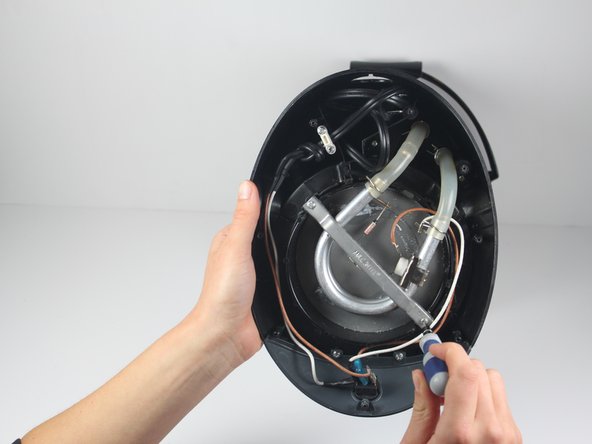

  4. Mr. Coffee DW13 O Ring Replacement, O Ring: crwdns2935265:04crwdnd2935265:01crwdnd2935265:02crwdne2935265:0 Mr. Coffee DW13 O Ring Replacement, O Ring: crwdns2935265:04crwdnd2935265:02crwdnd2935265:02crwdne2935265:0
    • Remove the two 13mm screws securing the silver support bracket using a #2 Phillips head screwdriver.
  5. Mr. Coffee DW13 O Ring Replacement: crwdns2935265:05crwdnd2935265:01crwdnd2935265:01crwdne2935265:0
    • Gently lift the silver support bracket freeing the heating plate from the heating coil.

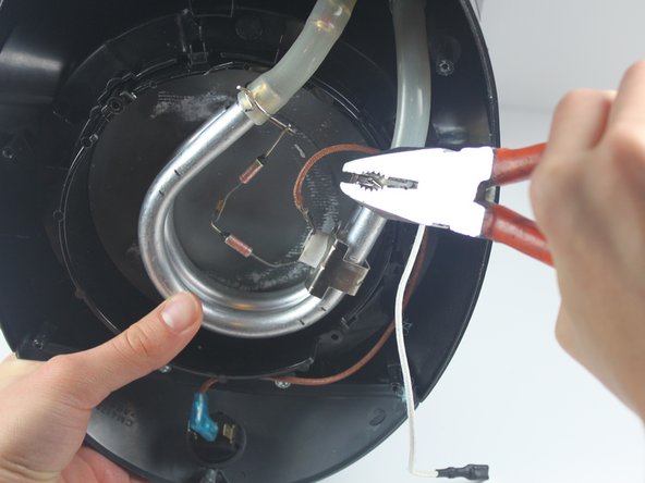

  6. Mr. Coffee DW13 O Ring Replacement: crwdns2935265:06crwdnd2935265:01crwdnd2935265:02crwdne2935265:0 Mr. Coffee DW13 O Ring Replacement: crwdns2935265:06crwdnd2935265:02crwdnd2935265:02crwdne2935265:0
    • Use needle-nose pilers to pinch and loosen the crimps
  7. Mr. Coffee DW13 O Ring Replacement: crwdns2935265:07crwdnd2935265:01crwdnd2935265:01crwdne2935265:0
    • Once the crimps are loosened, slide them down the tubing.

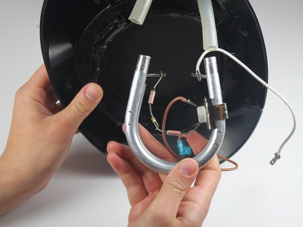

  8. Mr. Coffee DW13 O Ring Replacement: crwdns2935265:08crwdnd2935265:01crwdnd2935265:02crwdne2935265:0 Mr. Coffee DW13 O Ring Replacement: crwdns2935265:08crwdnd2935265:02crwdnd2935265:02crwdne2935265:0
    • Separate the tubing from the heating coil by grasping the tubing in one hand and the heating coil in the other and gently pulling apart.

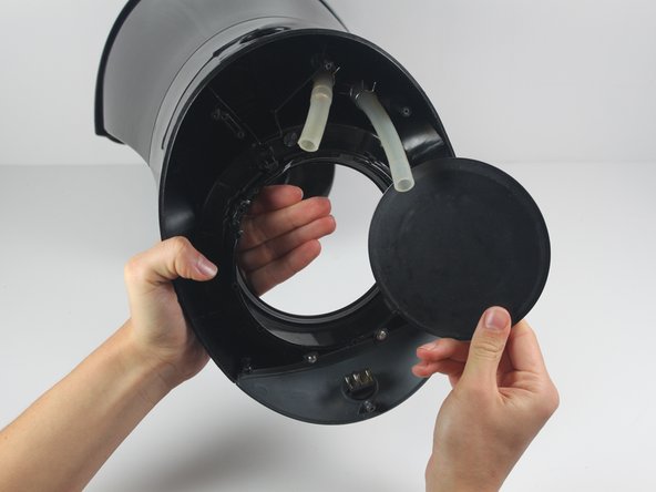

  9. Mr. Coffee DW13 O Ring Replacement: crwdns2935265:09crwdnd2935265:01crwdnd2935265:02crwdne2935265:0 Mr. Coffee DW13 O Ring Replacement: crwdns2935265:09crwdnd2935265:02crwdnd2935265:02crwdne2935265:0
    • Place one of your hands on the front side of the heating plate.
    • Use this hand to gently push the heating plate towards yourself and out of the machine.

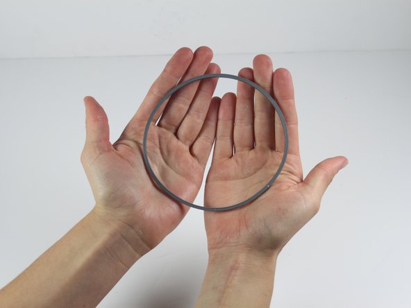

  10. Mr. Coffee DW13 O Ring Replacement: crwdns2935265:010crwdnd2935265:01crwdnd2935265:02crwdne2935265:0 Mr. Coffee DW13 O Ring Replacement: crwdns2935265:010crwdnd2935265:02crwdnd2935265:02crwdne2935265:0
