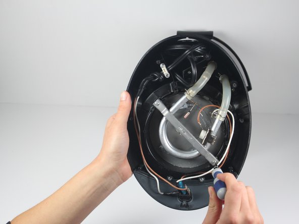

    • Using the Phillips Head #2 screwdriver, remove the two 13 mm screws that secure the silver support bracket.
  5. Mr. Coffee DW13 Heating Plate Replacement: crwdns2935265:05crwdnd2935265:01crwdnd2935265:01crwdne2935265:0
    • Gently lift the silver support bracket to free the heating plate from the heating coil.

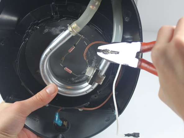

    • Pinch and loosen the crimps with the needle-nose pliers.
  7. Mr. Coffee DW13 Heating Plate Replacement: crwdns2935265:07crwdnd2935265:01crwdnd2935265:01crwdne2935265:0
    • Once the crimps are loosened, slide them down the tubing.
  8. Mr. Coffee DW13 Heating Plate Replacement: crwdns2935265:08crwdnd2935265:01crwdnd2935265:02crwdne2935265:0 Mr. Coffee DW13 Heating Plate Replacement: crwdns2935265:08crwdnd2935265:02crwdnd2935265:02crwdne2935265:0
    • Separate the tubing from the heating coil by grasping the tubing in one hand and the heating coil in the other. Gently pull them apart.

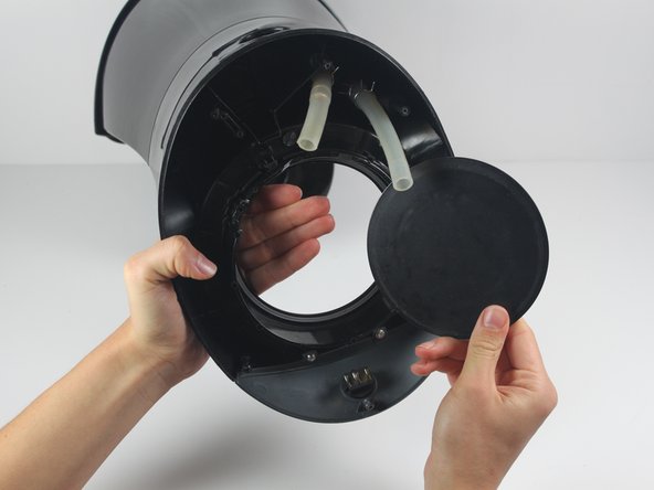

  9. Mr. Coffee DW13 Heating Plate Replacement: crwdns2935265:09crwdnd2935265:01crwdnd2935265:02crwdne2935265:0 Mr. Coffee DW13 Heating Plate Replacement: crwdns2935265:09crwdnd2935265:02crwdnd2935265:02crwdne2935265:0
    • Place your hand on the front side of the heating plate and push towards the bottom of the coffee maker to pop the heating plate out of place.

Before removing anything, do an in circuit resistance of those two small copper colored cylinders with a black end.
They are thermal fuses, and should have in circuit resistances close to zero.
Their placement is important, especially the one under the silver support bracket.
