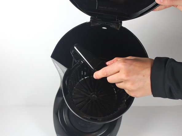

    • Face the top of the coffeemaker towards you.
  2. Mr. Coffee DW13 Filter Replacement: crwdns2935265:02crwdnd2935265:01crwdnd2935265:02crwdne2935265:0 Mr. Coffee DW13 Filter Replacement: crwdns2935265:02crwdnd2935265:02crwdnd2935265:02crwdne2935265:0
    • Identify the two tabs on top of the machine.
    • Lift the top of the coffeemaker up, using these tabs
  3. Mr. Coffee DW13 Filter Replacement: crwdns2935265:03crwdnd2935265:01crwdnd2935265:03crwdne2935265:0 Mr. Coffee DW13 Filter Replacement: crwdns2935265:03crwdnd2935265:02crwdnd2935265:03crwdne2935265:0 Mr. Coffee DW13 Filter Replacement: crwdns2935265:03crwdnd2935265:03crwdnd2935265:03crwdne2935265:0
    • Slide the black spout towards the back of the coffee maker, exposing the filter.
  4. Mr. Coffee DW13 Filter Replacement: crwdns2935265:04crwdnd2935265:01crwdnd2935265:02crwdne2935265:0 Mr. Coffee DW13 Filter Replacement: crwdns2935265:04crwdnd2935265:02crwdnd2935265:02crwdne2935265:0
    • Using the side tabs, gently lift the filter up and out of the machine.
