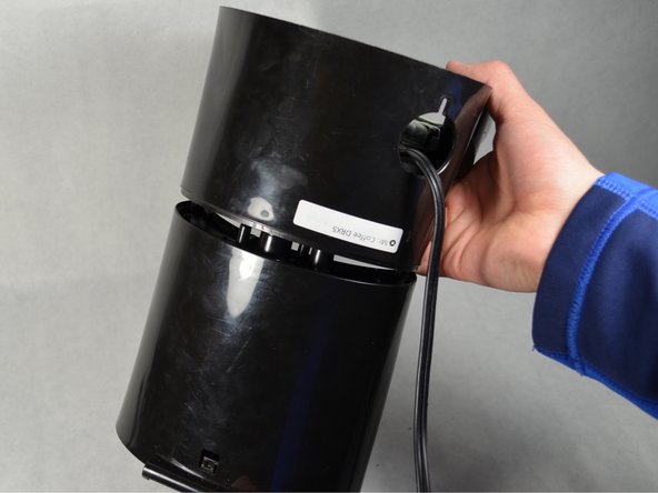

    • Use a Phillips #1 screwdriver to remove the two 9mm screws and the three 11mm screws on the bottom of the coffee maker and remove the bottom plastic cover.

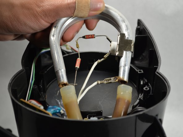

    • Using a Phillips #1 screwdriver, remove 12mm screws from heating element bracket and remove bracket.
  3. Mr. Coffee DRX5 Water Reservoir Replacement: crwdns2935265:03crwdnd2935265:01crwdnd2935265:02crwdne2935265:0 Mr. Coffee DRX5 Water Reservoir Replacement: crwdns2935265:03crwdnd2935265:02crwdnd2935265:02crwdne2935265:0
    • Remove 2 hose clamps from heating element. Remove heating element from tubes.

    • Using a Phillips #1 screwdriver, remove one 10mm screw, and three 11mm screws connecting the reservoir to the base and remove reservoir from the base.
